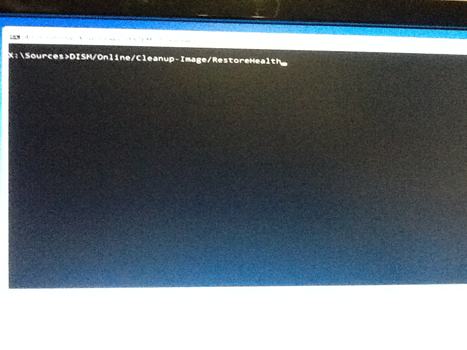

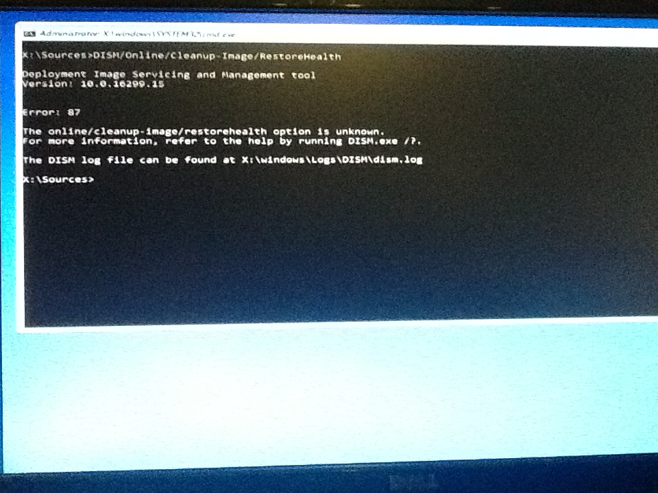

The problem seems to be in the BCD file, as it says that something is missing, is there any way to get into or rewrite that file?

Try sfc /scannow there is a guide for this here you will need to have your Windows 10 media in the computer for this.

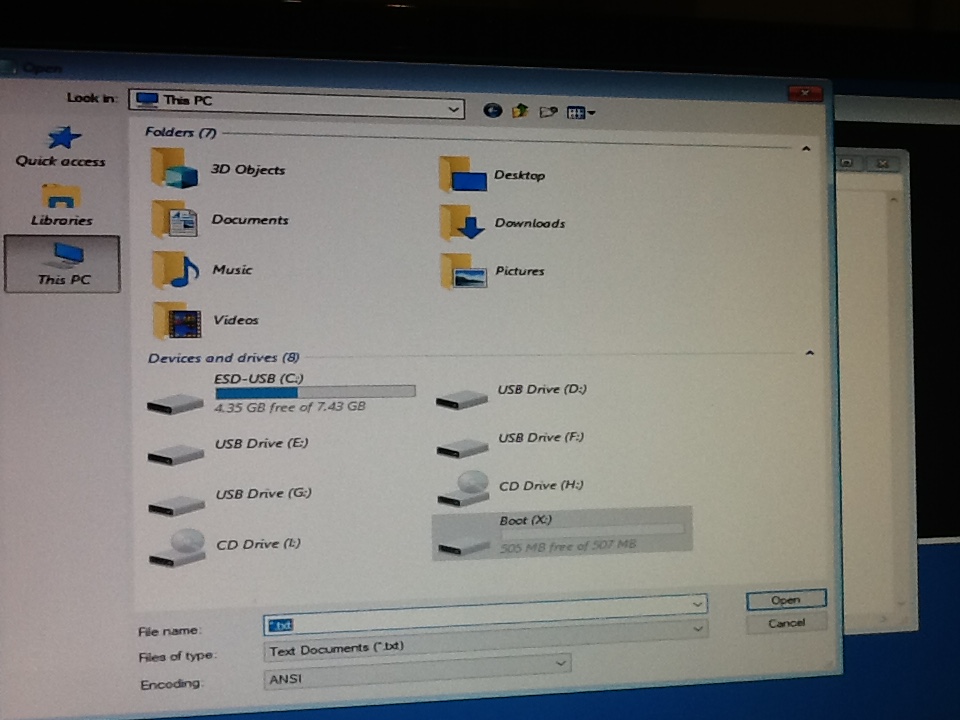

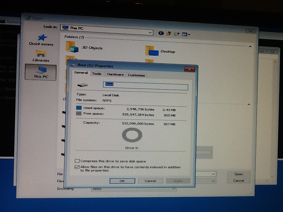

thought it may be worth a look at the properties of the only local drive I seem to have

I am confused now as well. How are you getting into File Explorer? Are you able to boot into Windows 10 and if so how?
#83
Jb852
Jb852
  • 214 posts
 followed the instructions in#77

I still believe the issues are related to the Raid configuration. I would recommend performing the following steps. Then you should be able to install Windows 10 on the one drive. Once it is up and running connect the other drive and we can help you get it working.
Boot with the Windows 10 USB
2. During the install select the Repair option to bring up the command prompt console
3. In the command prompt type each of the following commands followed by pressing enter key
diskpart
list disk 0 (verify it is the correct disk #)
clean
convert gpt
create partition primary
format quick fs=ntfs
assign
exit
4. This should allow you to then select the unallocated partition to install Windows onto

I understand and we are trying our best to help. It looks like you have installed Windows 10 now but none of your hard drives are showing up under file explorer, etc. Do you have a full Windows 10 desktop with Start menu etc?
Okay, I understand what is going on now. You are just using Notepad to open file explorer. So yes, please get to a command prompt and follow my commands.
