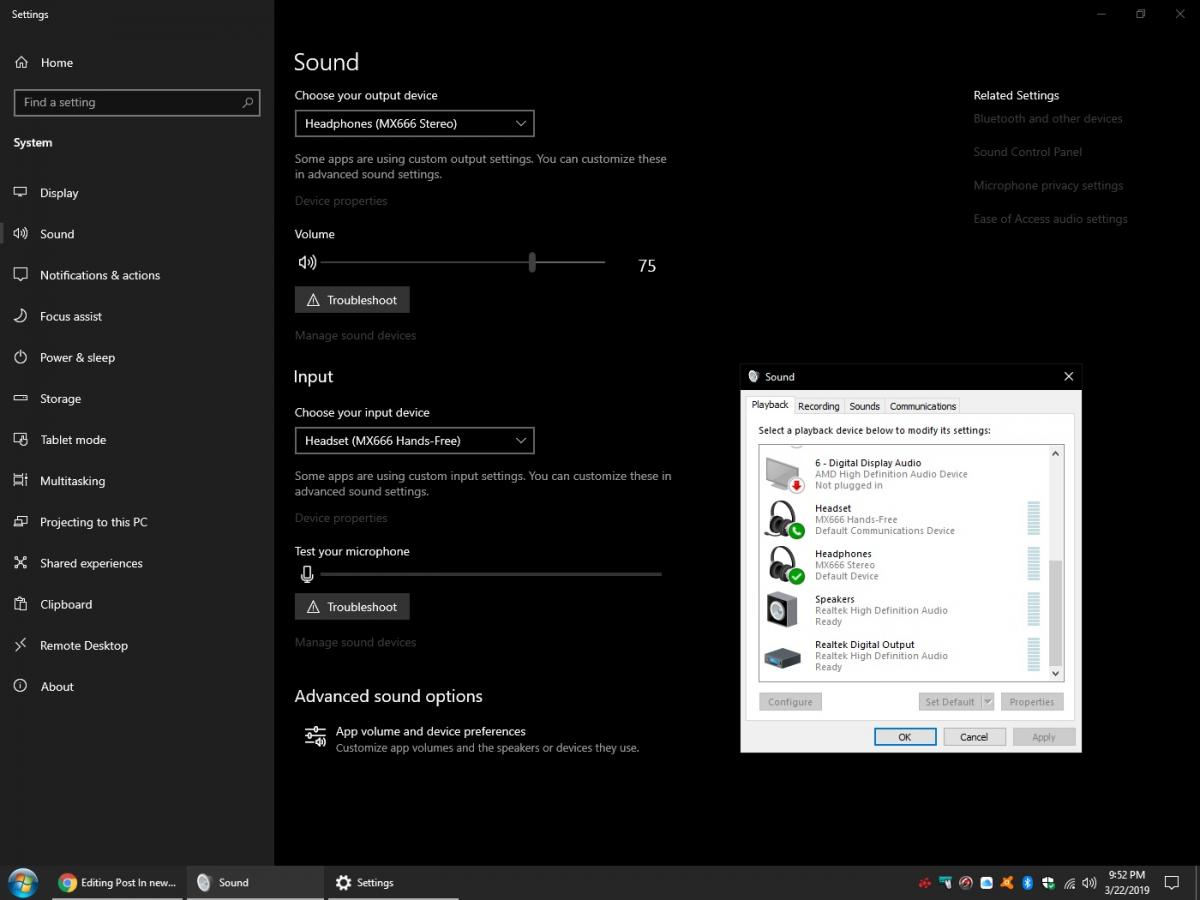

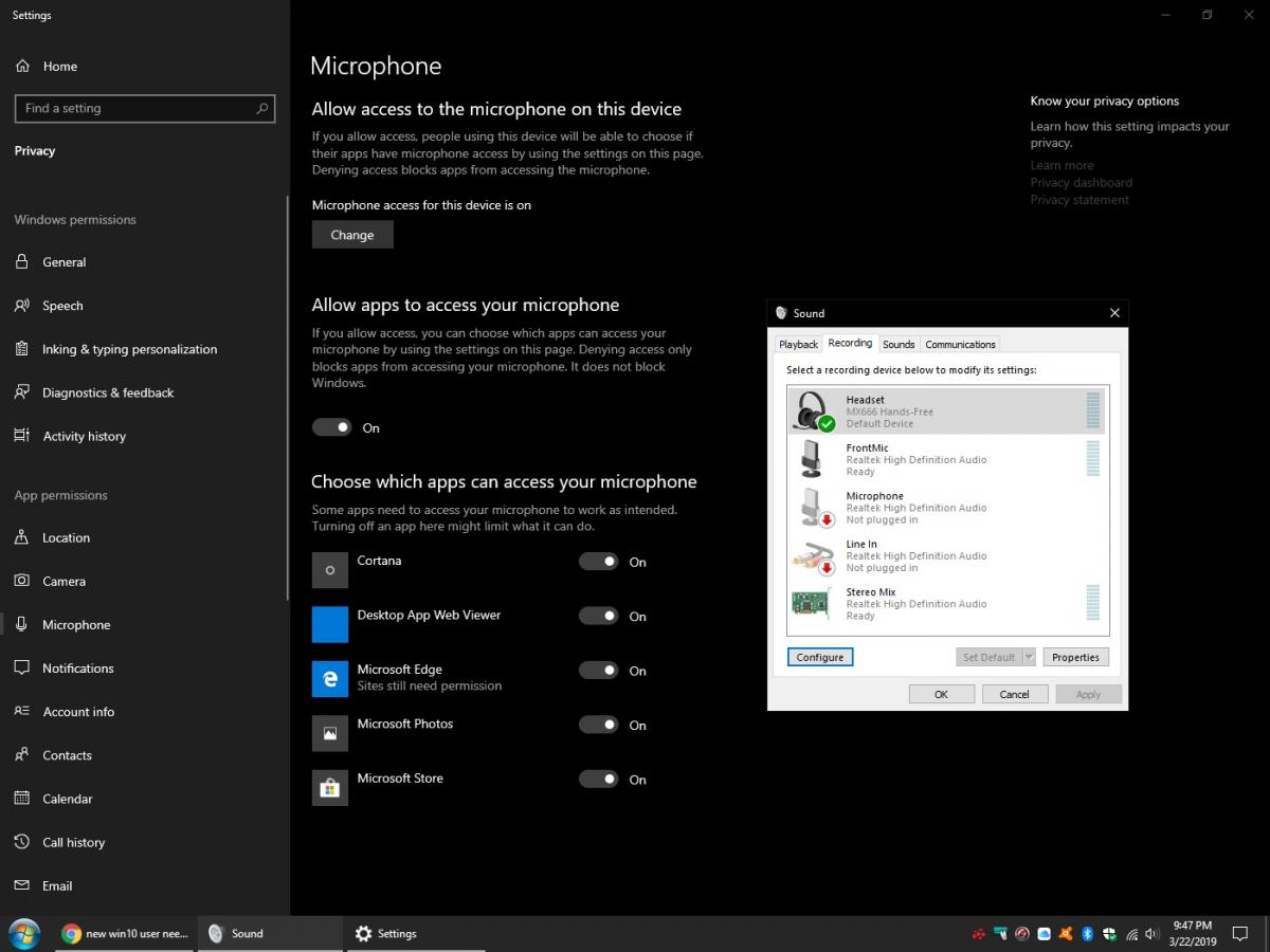

there was a windows update and now the microsoft audio stuff that was listed under the sound devices is gone. but heres some sfreen shots of the devices i see. the mx666 is my gaming headset that the mic wont pick up sound.
and as you can see the mic privacys are turn on to allow use. also in the pic you can see the mic slider bar i mentioned earlier and how its not there and the headset is selected

  • 25,142 posts
this copy of win10 is technically an upgrade from win7 home... but i dl the win10 copy from MS (put in my win7 key) put it onto a usb on my laptop then did a clean install on this one.
After the clean install of Windows, did you reinstall the drivers for the MB and starting with the chipset drivers first.
Its a gaming headset with built in mic. Idk the brand but the model is mx666. Its a generic set so theres not really a mfr website. Windows already installed the drivers and updated them.
As above but in addition, when possible you should always install drivers provided by the manufacturer of the device that you are trying to install and not let Windows install what it deems best, as your headphones are "plug n play" there are no specific drivers for them but there is for the Bluetooth device on the MB, was the Intel Bluetooth driver installed after you clean installed Windows 10.
All required drivers are on a disk that you may have gotten when you purchased the MB/system but if not you can download them from here and save them to a USB thumbdrive.
Not sure if you have seen it already but there is a helpful "plug n play" guide here
