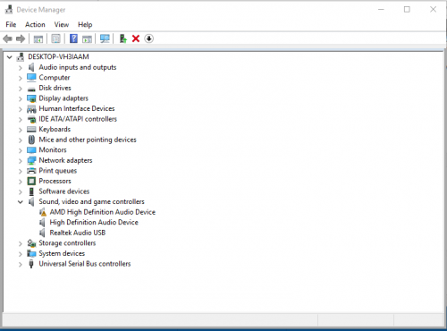

AMD High Definition Audio Device > This device cannot start. (Code
Audio Sound Device Code10

I have a custom built desktop with these specs :
Motherboard : ASRock 960GM-VGS3 FX
CPU : AMD FX-4300
GPU : Asus Radeon RX 470 Series
8GB RAM
Kingston SSD 128Gb + HDD 500Gb
No matter what I do I can't figure out a way to remove the error from the AMD High Definition Audio Device , The computer is connected to the TV with a DVI to HDMI adapter ( it might be the reason I don't get sound) I have another Device which is Realtek Sound Device ( I use it for Headphones )
I want to know that if the DVI is unable to send sound information to TV will it cause the AMD Audio Device to display the Code 10 error ?
To fix the Code 10 error , I tried to Start the Service , To Install Windows Drivers , To Install from Driver  Easy , Tried to Update Windows , I tried the Fresh Windows 10 installation as well .
Thank you for any reply.

:welcome:   CJaafar,
The default audio is the MBs own Realtek device that you are using for your headphones, the AMD device is associated with your graphics card audio capability which is secondary to the Realtek device so the AMD audio will not work in any event.
You can get audio to work through a DVI to HDMI adapter but it does require a bit of work and financial outlay , see info here
