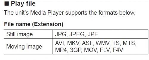

I have an 8 GB USB Flash/Pen Drive which has some music in the MP3 format. The songs play well when I plug in the pen drive into my laptop; however, when I plug in the same drive into my TV USB port, I get a message saying "unrecognized format.  My TV is a Panasonic Viera.
Any suggestions?
Thanks in advance.
  • 24,624 posts

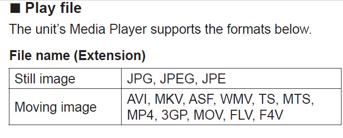

Above is from the manual
https://www.google.c...ln9lojPtOsIWic6
As you can see MP3 is not one of the formats it expects.  You can convert MP3 to MP4 if you really want to go to the trouble.
