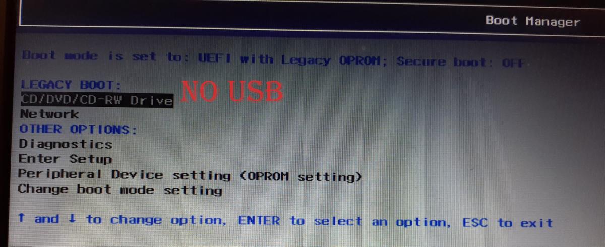

JohnGo
JohnGo
  • 339 posts
In Boot Manager the top one is LEGACY; the 2nd one down is USB STORAGE DEVICE highlighted in black.
peterm
peterm
    Trusted Tech
  • 3,462 posts
not in this pic
