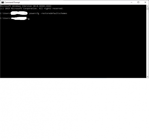

EDIT: I copied and pasted your command prompt, as I didn't realize there was a space. See command2.png. Nothing changed when I went into power settings.

Not sure what has happened there as the Power Plan is Windows as opposed to HP software related, did you restart the notebook and then check the Power Plan options.

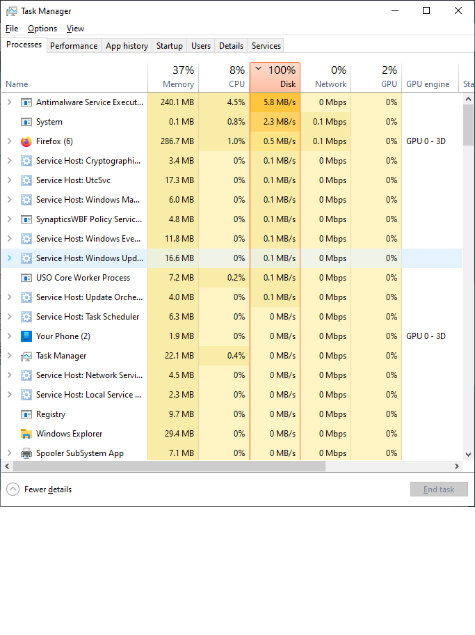

I did restart the notebook initially and there was no change to the Power Plans. This morning when I saw your reply, I did go to power settings, changed a custom setting to High Performance and it did not seem to make ay difference after I powered on the computer. It stayed at a light black screen for about a minute or two and then started loading. When it did reload, it automatically brought up the page I was on last. I checked the task manager and I screen shot what it looked like about five full minutes after I began the process.

  • 25,111 posts
Thanks for the update but can I ask that you please keep Twitch out of the equation, we are only trying to sort out the slow boot times at the moment and as mentioned on two previous occasions slow boot times and Twitch are most unlikely related, poor computer spec and internet service are likely to cause problems with Twitch but neither will have any bearing on boot times.

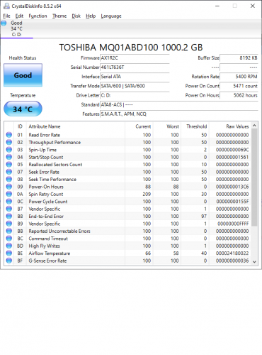

Not a good sign still being slow in a clean boot environment, it only leave hardware or Windows as being the cause, we will check the health of the HDD next.
Download and run CrystalDisk info standard edition from here
Run the program, grab any screenshots and attach to your next reply for us if you will.

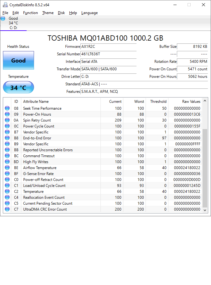

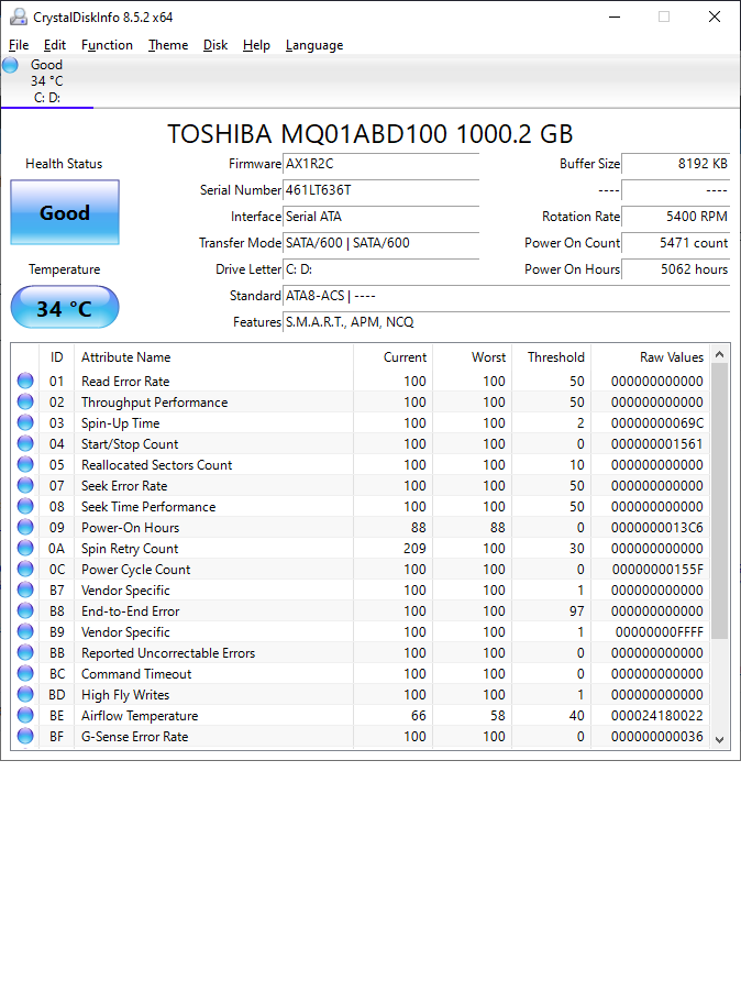

I took two screenshots in case it didn't show on one page :)

The HDD being the 5400rpm type will be slow but you would be used to that so that is not the issue and there looks to be nothing amiss with the drive itself.
