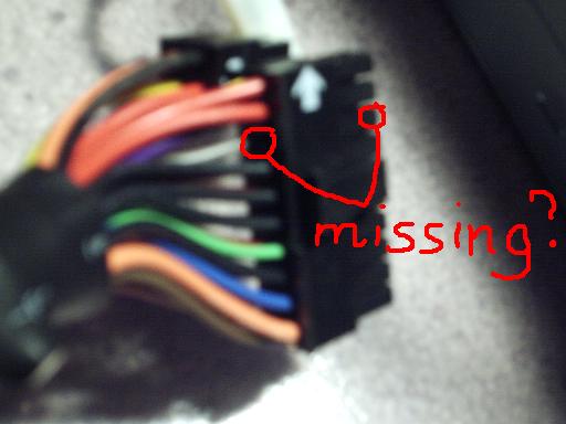

hello I'm back. OK, so i bought a new psu. OCZ ModXStream-pro 700w modular 80 plus certified sli-ready. i hooked everything up, and powered on. Cpu turns on, all fans are turning (including gpu), but my monitor is blank. little orange light instead of blue.
At this point i should mention that this happened with my old power supply. At first my computer was crashing from overheating, as i've posted, and then one day my monitor was blank after i booted up my computer (my friends told me i shouldn't have even been turning it on once i knew the PSU was faulty, d'oh). So i figured the power supply broke down even more, maybe wasn't giving enough power to the video card or something. The store clerk from where i bought my new psu said that a faulty psu could damage other hardware if it was still being used (D'oh). Ok so this is where i figure maybe it broke my video card. No biggy i guess, since i'm planning on getting a new one. My question is how can i be sure? could it be something else. Like i said everything "sounds" fine when i boot my pc up, but my monitor is blank.
Now i don't know much at all about psu's, but could my problem at all be related to this main power connector on my new psu? (refer to screenshot)
as you can see one of the pins/wires isn't there.

Nope that is normal. Now have you tried a different monitor to verify it is the monitor or the video?

Unless you have a hanging wire then the connector was never put in the connection. The wiring is decided by motherboard manufacturers and it is pretty standard now. The connection is there most likely to give it a completed look and nothing more.
