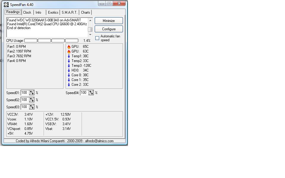

I ran the steps last night, it took like 3 1/2 hours thats why I havent responded. I just played bad company 2 for about 2 hours with no crashes so, so far so good!. Thanks alot for the help. Now I just need to figure out some way to get my case cooler, speed fan has my gpu at 78 celcius.

there ya go
Your video card seems to be running a little hot for not doing anything graphic intensive.
Check the fan on the card as I instructed because it seems it is not cooling correctly.

everything seems to be fine with the fan. it has one of those long fans on the top that pushes air out of the back, I also have a case fan directly above it, and a pci slot fan next to it.
