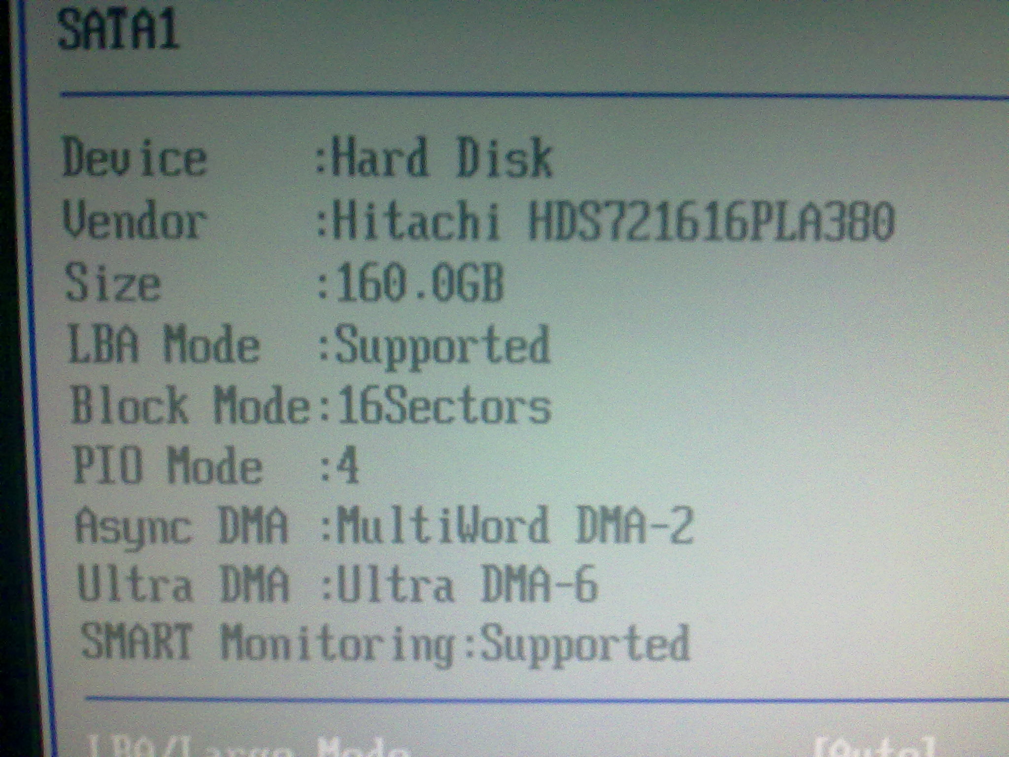

OK in the bios when you first enter you will see the Main Window with the list of your HD's.
If you click on the one with your hd you should get a sub menu that opens and you should see the Mode type of the controller.
Let me know if you see this.

Sergeras
Sergeras
  • 40 posts
OK no problem I will be here most of the day. :)
I have no idea what you were talking bout but this should do the trick. :unsure: Everything in the options below this is auto.

#50
Yep the drive is set correctly.
