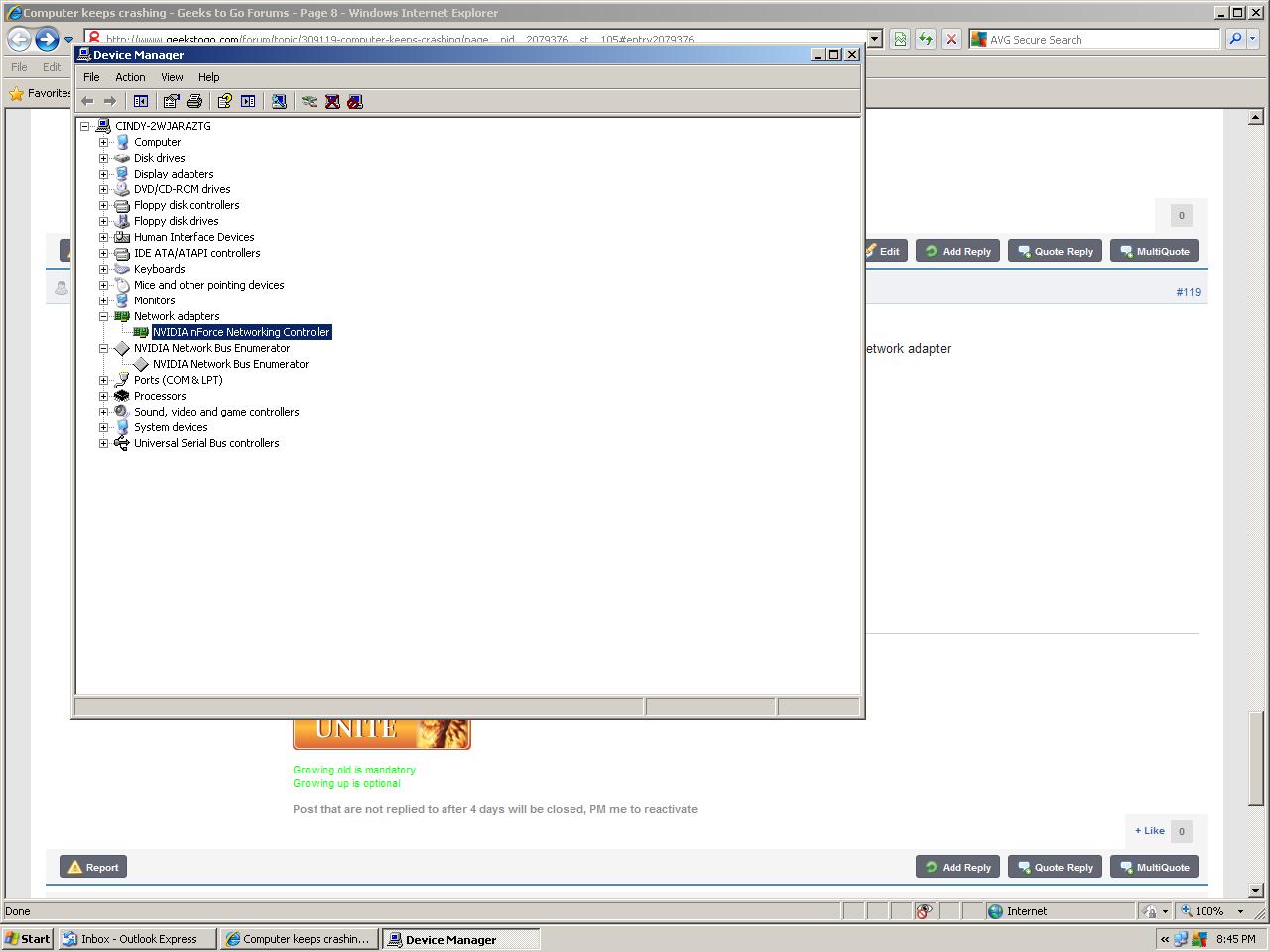

Could you go to Control Panel > Device manager and look for any yellow exclamation marks by the network adapter
Could you give me any details that appear on the adapter
#120
Cindy Pryt
Cindy Pryt
  • 106 posts
my old modem connects . the is whati found in device manager
