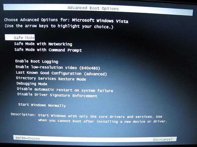

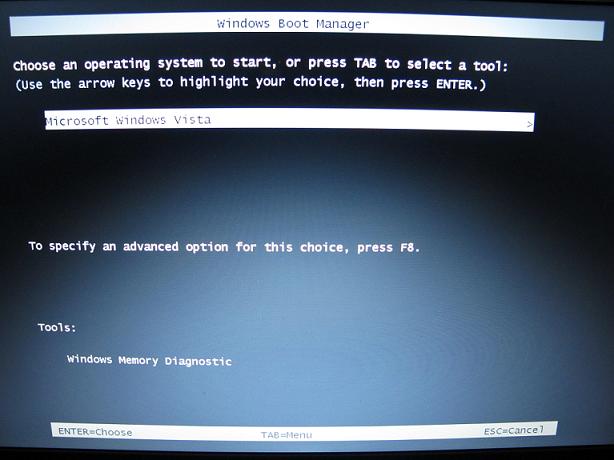

ops, sorry, didn't know that I have to set it up to boot from CD. I thought once the bootable CD is in the drive, it will auto start using the CD.
Anyways, I tried hitting DELETE key during restart, and it goes to Windows Boot Manager screen:
With Microsoft Windows Vista highlighted, I hit F8, it goes to the Advanced Boot Options screen:
No options to select boot drive.
I tried to restart again, and on Windows Boot Manager screen, I tried to hit [Enter] while Microsoft Windows Vista is highlighted, and of course, it also goes to the Advanced Boot Options screen.

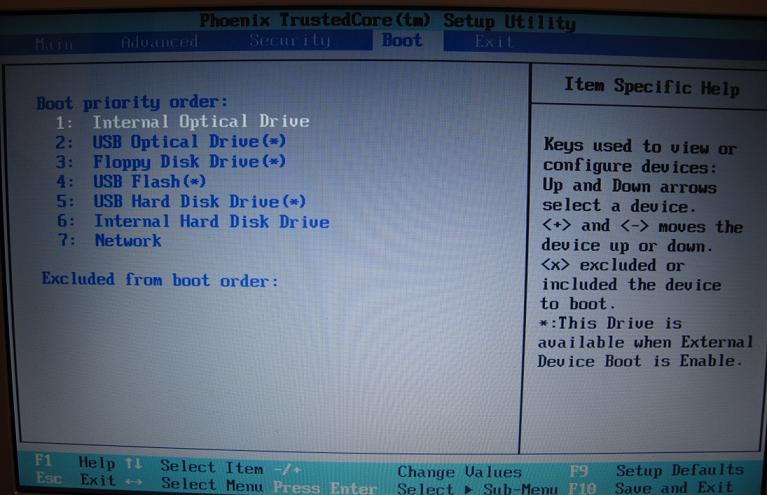

#143
Posted 21 November 2011 - 01:39 PM
As soon as you start the computer and when the manufacturers log flashes up - there should be an option displayed on the bottom of the screen to enter either BIOS or system setup
The key is usually delete or F2
Do you see that as soon as the system boots ?

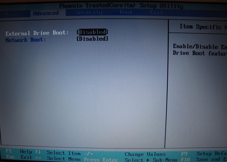

Posted 23 November 2011 - 04:15 AM
Thanks! I got the Setup Utility when I hit F2 as soon as the logo displayed on screen.
I tried to change some settings, which I think is the one that should be changed, and reboot my machine on every change.
But still, it won't boot from the DVD.
Here are the screens that I have:
This is the Advanced tab screen:
- I tried changing External Drive Boot to [Enabled]
And this is the Boot tab screen:
- I tried different Boot priority order
- I also tried excluding Internal Hard Disk Drive, and Network from boot order. But I got error saying "Operating System not found" on reboot.

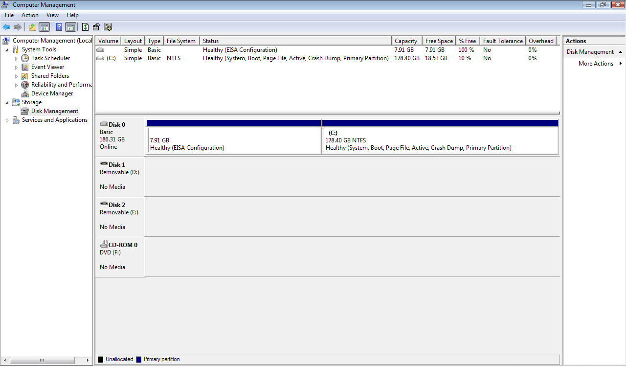

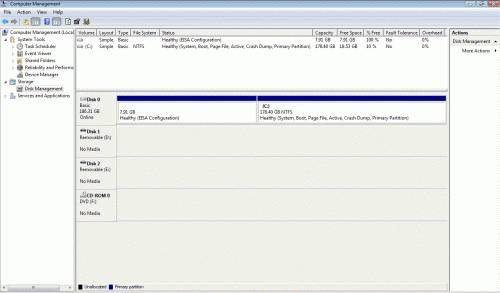

#149
Posted 24 November 2011 - 12:39 PM
Do the following:
- Click on the Start button and then choose Control Panel.
- Click on the System and Security link.
Note: If you're viewing the Large icons or Small icons view of Control Panel, you won't see this link so just click on the Administrative Tools icon and skip to Step 4. - In the System and Security window, click on the Administrative Tools heading located near the bottom of the window.
- In the Administrative Tools window, double-click on the Computer Management icon.
- When Computer Management opens, click on Disk Management on the left side of the window, located under Storage.
