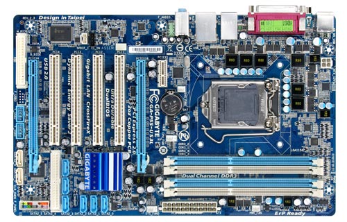

indeed i place both into the blue slotsIs this your motherboard HERE?
If so I see the memory slots are colored so you would have to make sure that the memory is in the blue slots first and then if you have 2 other modules they would go into the white slots.

HOWEVER having looked at the motherboard you MAY have the ram in the wrong slots
If you do not have the motherboard manual, download it from here and check which blue and which white are to be used to populate with one stick in each.
http://download.giga...tpm)_v2.3_e.pdf
I have downloaded it for you see page 16 Section 1.4.1.
From the processor to the right hand edge of the board the slots are numbered 2, 1, 4 and 3
when using dual channel with two sticks insert then in 1 (ONE) and 3 (THREE). THE WHITE SLOTS
That is the second slot from the processor and the last slot. and unless I am mistaken which I do not think I am, those are the white slots.
From motherboard manual
when enabling Dual Channel mode with two memory modules, be sure to install them in the DDR3_1 and DDR3_3 sockets.
If that does not work place one stick in slot 2 and one stick in slot one., and you will still have the 4Gb but in single channel
