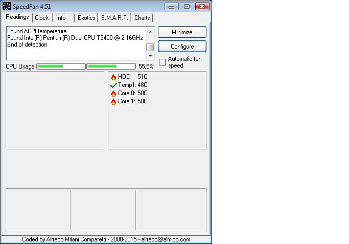

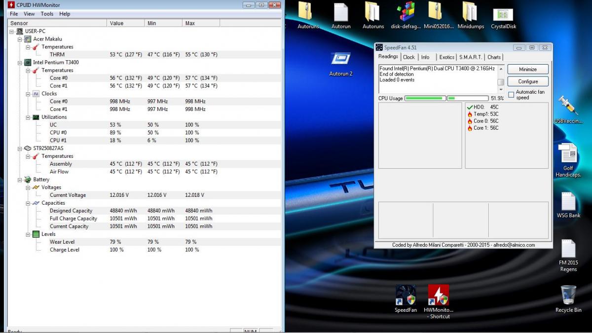

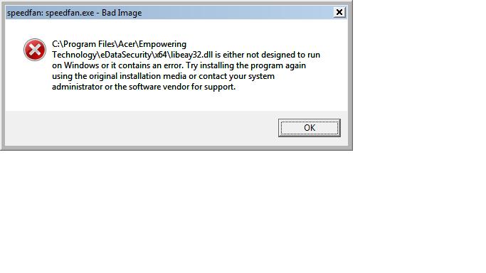

I'm sending three screenshots here.
The first is a SpeedFan error message I get whenever I try to run it, (as Admin), despite downloading it several times!
The second one is a SpeedFan screenshot with much information missing, presumably due to the error message.
The third one is HWMonitor which ran without a problem.
I hope you see something obvious!

  • 25,105 posts
Your HDD is running hot causing performance to suffer, when if ever was the notebook cleaned out of heat trapping dust.
Example cleaning guide here

  • 161 posts
Hi phillpower2

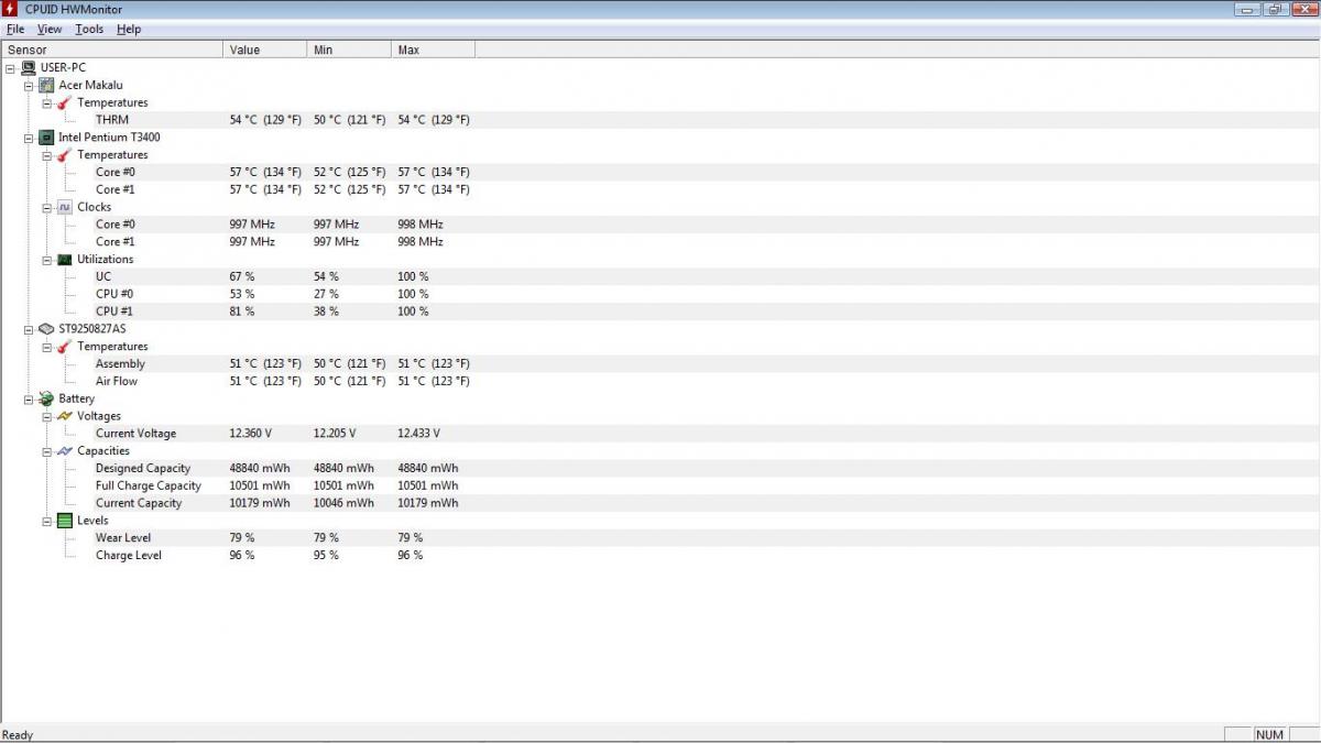

I've given the machine a good clean with compressed air.
I'm still having problems with shut downs & boot ups and the machine is still very slow, especially when opening up more than one tab at the same time!
I've attached a screenshot of my temps after cleaning the laptop.
Thanks as always;
  • 25,105 posts
Hi Slime,
No change in the HDD temps + high CPU usage for a computer that is not under load.

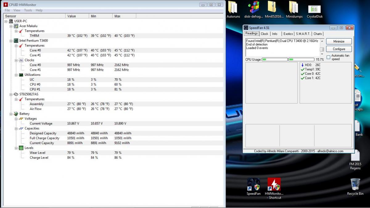

Quick check that you can do for us if you presently have the AC adapter connected to and powering up the notebook;
Shut down the notebook, disconnect the AC adapter, leave the notebook somewhere cool for around an hour, restart it on battery power only, check and make a note of the HDD temps and then do the following for us;

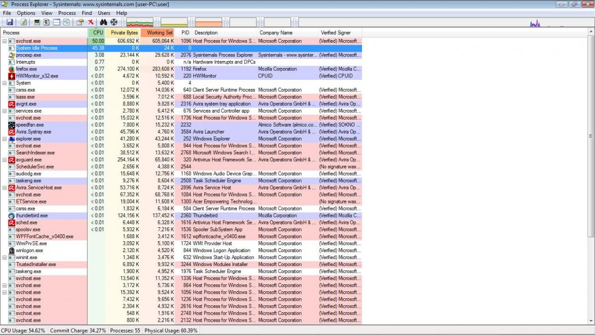

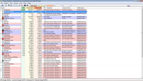

Download Process Explorer which you can obtain from here
Save it to your desktop then run it (Vista or Win7 - right click and Run as Administrator).
 Click twice on the CPU column header to arrange things by CPU usage, this will put the services with the highest CPU usage at the top of the log.
Wait a minimum of a minute then grab a screenshot and attach it to your next reply for us please.

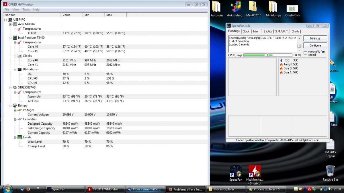

  • 161 posts

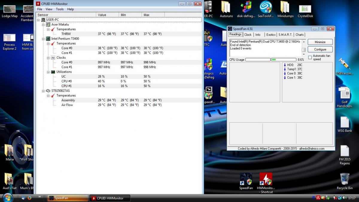

What I've done is give you two sets of temps, I hope that's okay!
The first was taken immediately after boot up and the second was done about five minutes later.
I've also sent the requested Process Explorer screenshot.
I don't think this is relevant, but, my machine's battery only lasts about 10 minutes as it's now about seven years old!
Edited by Slime, 25 May 2016 - 03:21 PM.
  • 25,105 posts
That`s ideal actually  :spoton:
Notice that the HDD temp in both screenshots is 27 and 33C respectively and that the CPU temp is up to around 57/58 after some use, the latter is normal for a notebook CPU and the former points towards the AC adapter being involved in the HDDs high temps, two possible reasons for this, 1: The AC adapter is defective and putting out too much voltage and 2: The battery being 7 years old and on its last legs is making the AC adapter work harder which in turn is creating over voltage and therefore more heat.

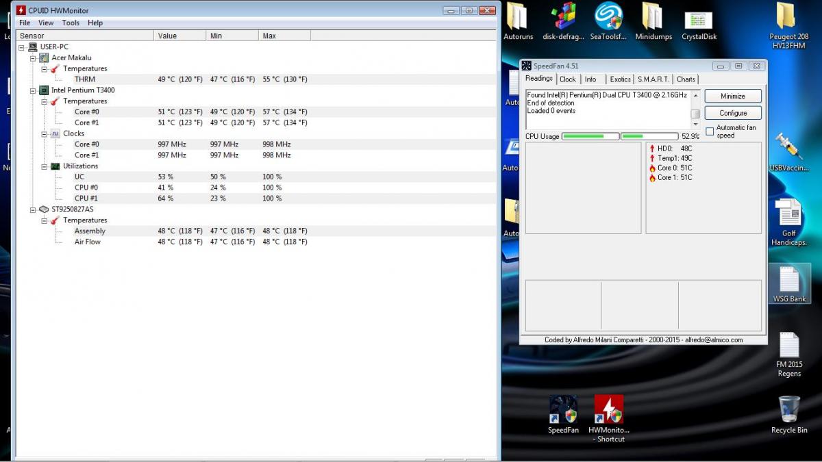

Please repeat the exact same procedure as above but this time with the main power brick removed and only the AC adapter powering the notebook.
Will come back to the PE log once the above has been done but fwiw the svch.exe reading covers a multitude of services and can show a high reading but at 50% is way too high and we need to check what the big hitters are.

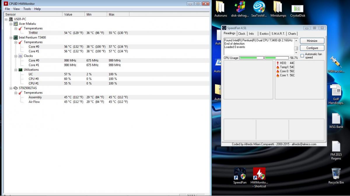

  • 161 posts
These are the screenshots with the battery removed.
One when laptop had just booted up, the other was after about half an hour.
  • 25,105 posts
Looks like you need to replace both the charger and battery I`m afraid  :(

  • 25,105 posts
In instances such as this I always recommend that members get a second opinion closer to home before making any purchase, any reputable local tech store will be able to test the notebook with an appropriate AC adapter.
Why I suspect that you need to replace both + an alternative option;
This proves that your battery is shot and being several years old is to be expected.
The HDD temperature does not get as hot on battery power.
The HDD does get hotter than it should be when only the AC adapter is being used which suggests that the adapter is putting out too much voltage and the battery not being in place means that it cannot be responsible in any way.
Alternative to replacing both items, if a local Tech confirms my suspicions about the charger, if you only ever use the notebook where there is a power outlet, remove the battery altogether and use an appropriate AC adapter to power the notebook.
