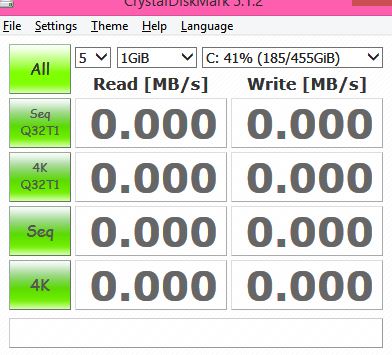

I am not doing very well at this sorry
is this ok I cant screen shot so I did something else
  • 25,142 posts
It is not you that needs to apologise dustypink, it is me as I post the wrong link  :blush: sorry, please uninstall CrystalDiskMark then download from source Shizuku Edition [Ultimate] from here

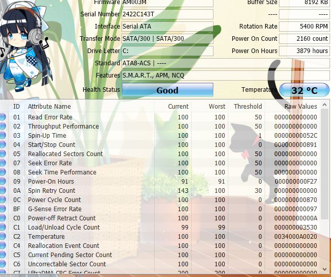

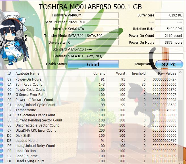

  • 432 posts
is this ok
  • 25,142 posts
Spot on and thanks for pointing dustypink to the download DS  :thumbsup:
Your HDD is in perfect working order so no worries there, the specs of the drive are not the best but that would not cause the problems that you described earlier.
