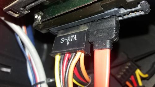

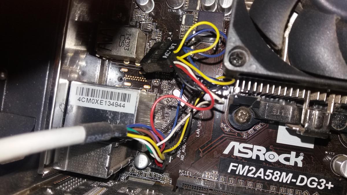

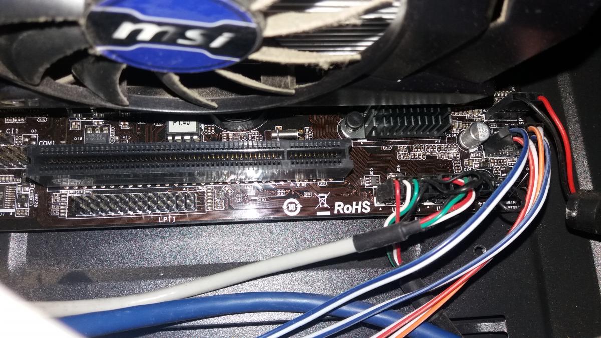

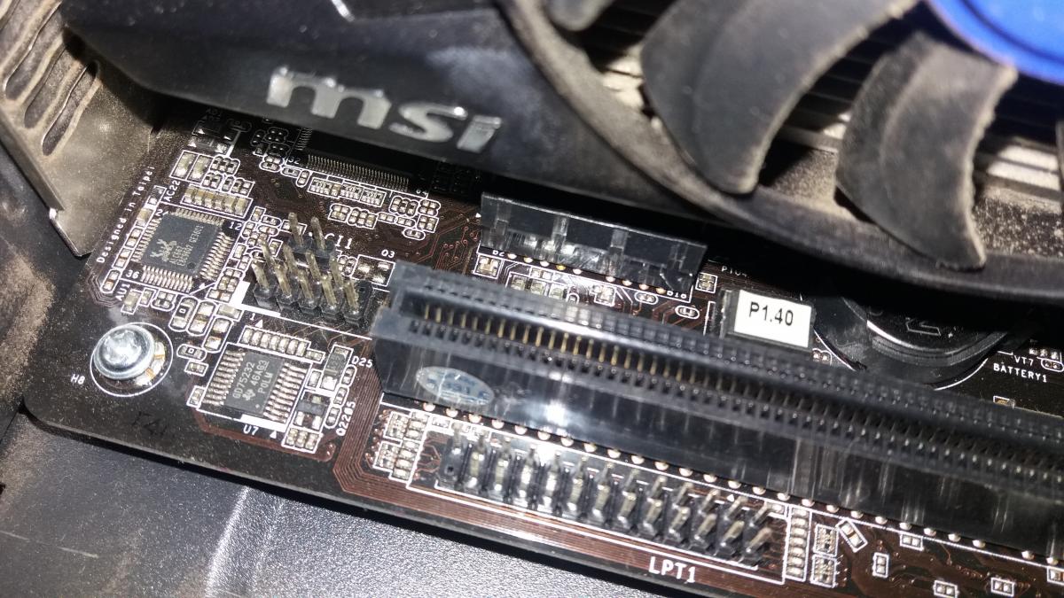

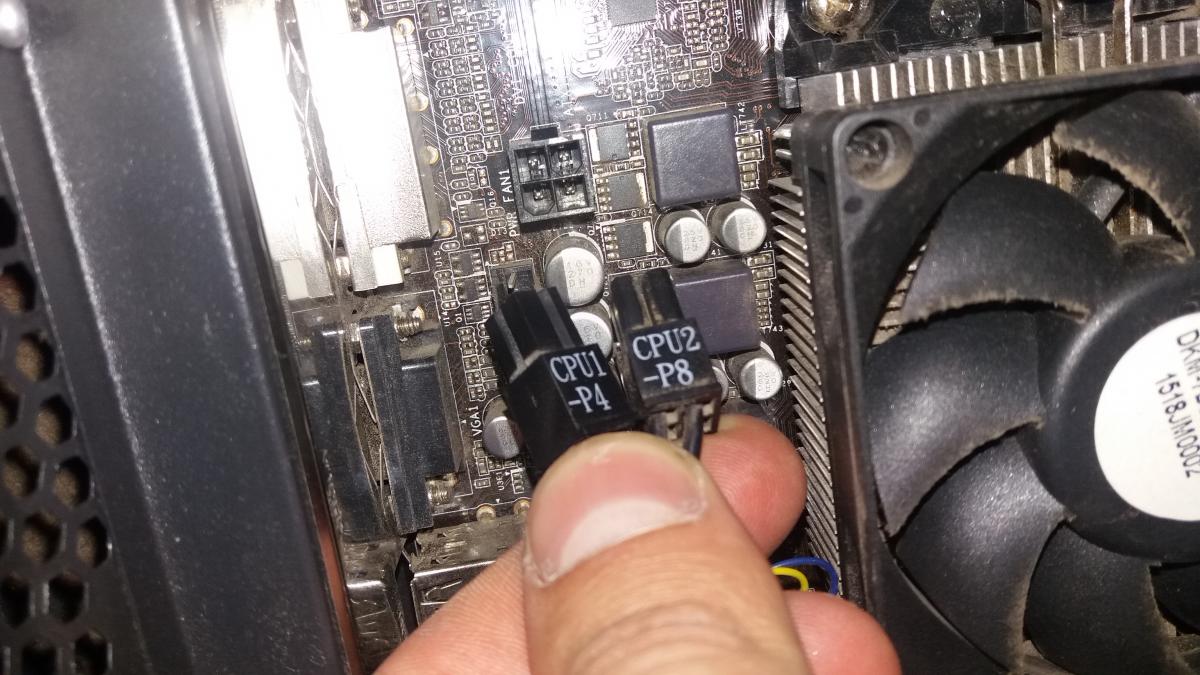

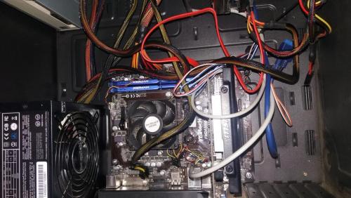

Well, so I replaced the PSU to my older but less used one, I was getting like a few FPS more maybe but that's it. So I have put my better one back.

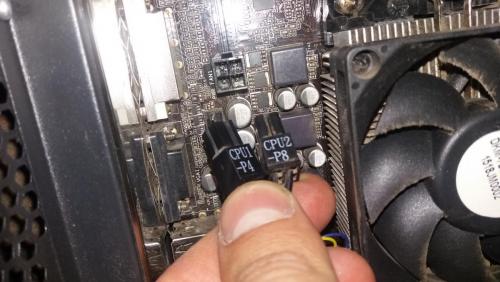

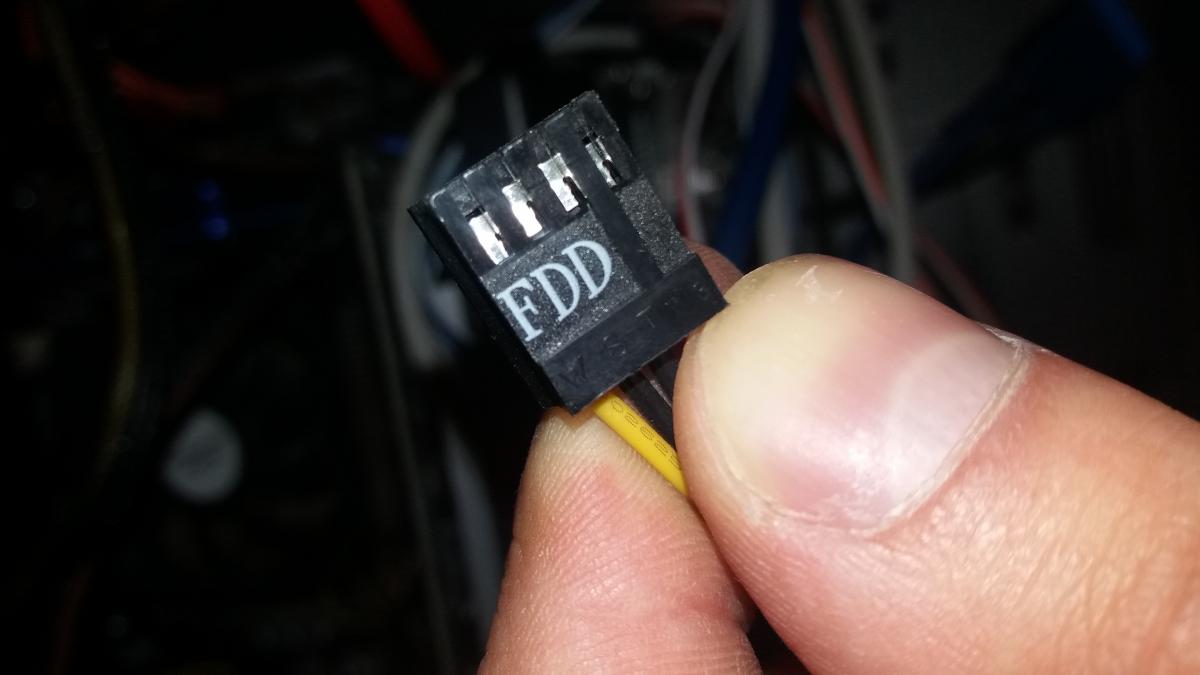

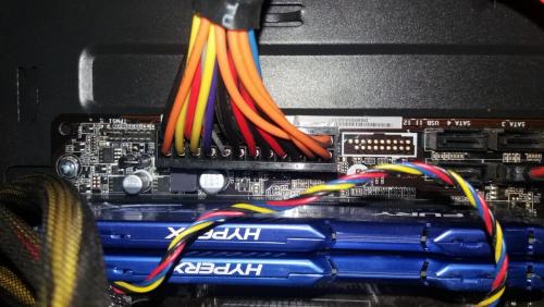

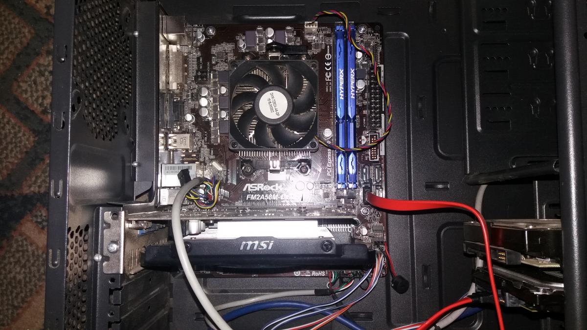

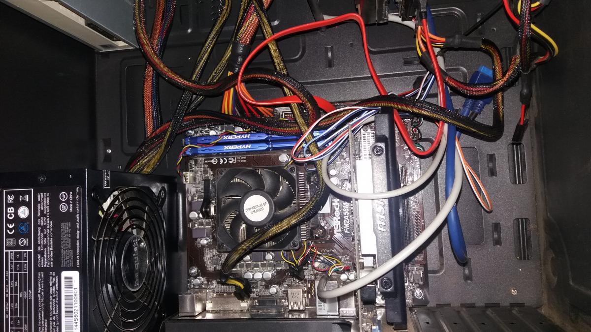

I also made the pictures with cables and all plugged in/out. I have some cables left like VGA(Blue/2x), AC 97 and FDD, also 2x CPU cables(I have plugged the CPU 1), not sure if they should be plugged anywhere at all. Adding pictures below

The VGA1 cables are power for the graphics card.  On some units they need separate cables because they draw too much to take it from the MOBO.
The loose AC 97 cable is for Audio.  Often there are two and you just get to use one based on what your MOBO supports.
FDD looks like power for a floppy drive.
CPU1-P4 and CPU2-P8 http://www.tomshardw...time-build.html
#110
zapuxas098
zapuxas098
  • 150 posts
So everything looks good?
I've tried connecting both, they both work. So which one should I use? I've read it all there but quite not my case as here all works in both ways

No place on the video card to plug in some extra power?

No idea which CPU connector to use.  Expect they if they are the same connector that the voltages are the same on each so doesn't really matter.

As far as I know GTX 750 Ti doesn't need an extra power cable

And yes, I guess they're the same in my case as I can't plug them both at the same time(got just 4 pins available at once), as I understood, some motherboards have 8 pins or so for extra power for a strong/overclocked CPU.
