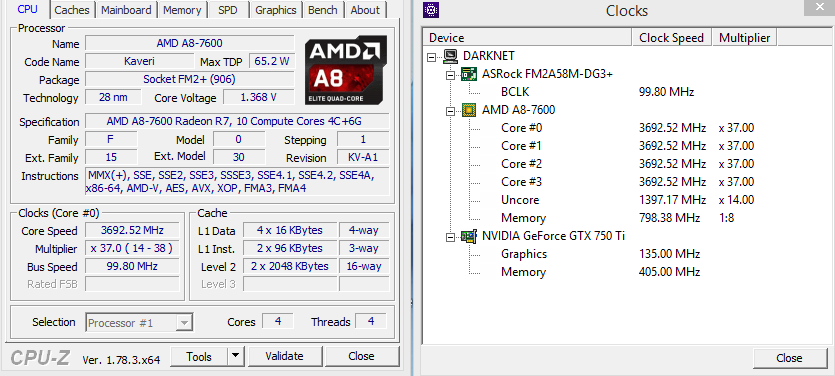

What does your CPU-Z say now that you have disabled the quiet option?

So which one should I use? And how long should it actually take to clone whole OS and around 200-300GBs of movies, etc?

You might try the OC Tweaker in the BIOS and see what you can do with the CPU speed that is now set to Auto

It quite would be an overclocking, wouldn't it be? As I already have boosted my CPU and reaching over 65C temperature, is it safe going more far if I can?

I think the Auto thing is what is overclocking the CPU now.  If you go in to the BIOS option you can probably change it back to the correct value so that you are not overclocking.

I think yes, auto makes it overclocked. But I am fine with it, if I turn it off, I lose the performance even more. I see no point turning the OC off for the CPU, the temperatures are reasonable either.
As HDD seems to be fine, the anti-virus changed, the OC kept as it was(It only increases the performance), is there anything else that could solve this performance loss which still kinda exists?
