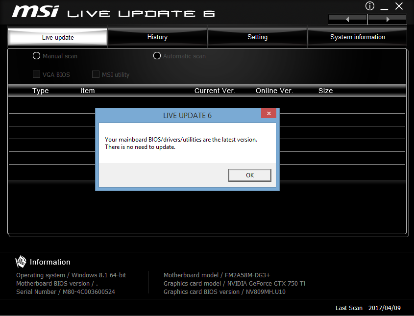

I downloaded MSI live , it auto detects stuff to download. I also looked for motherboard drivers there, couldn't find the one I have, mine is DG3+, there was some ending differently.
But as I installed MSI live, it auto detected my rig, I got this message:

#71
  • 24,736 posts
Did you get

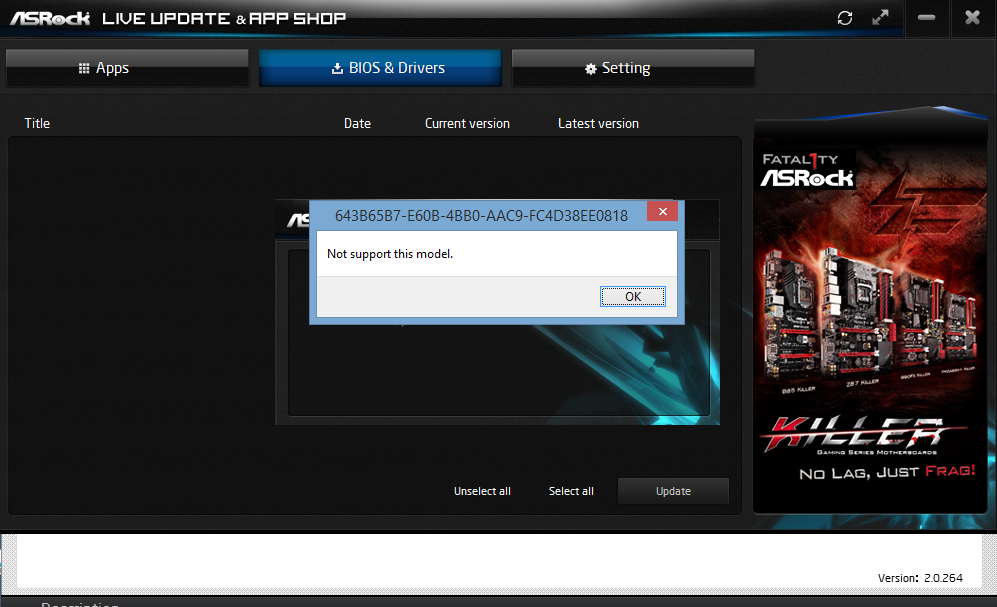

#72
zapuxas098
zapuxas098
  • 150 posts
Yep I had it, but here is what I get after I try searching for updates:

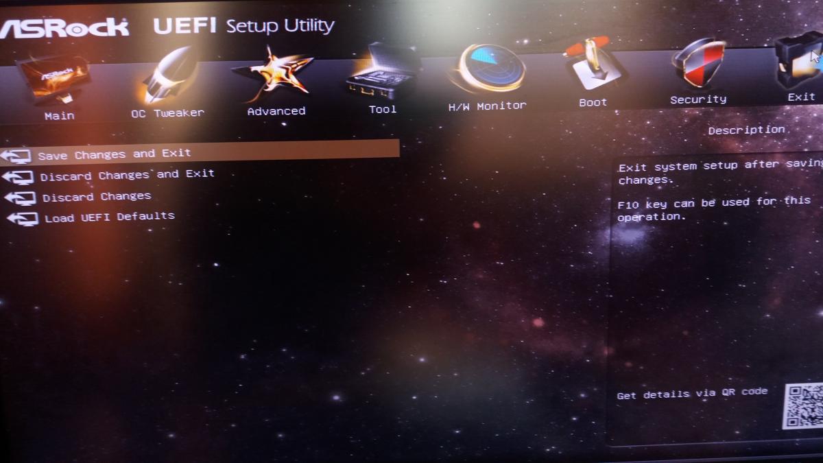

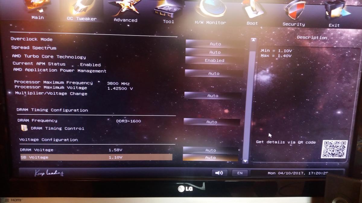

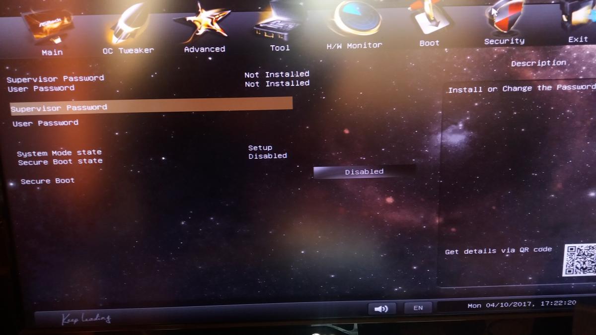

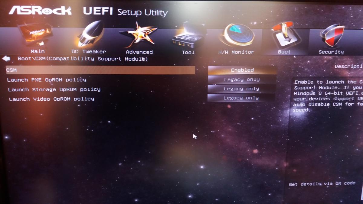

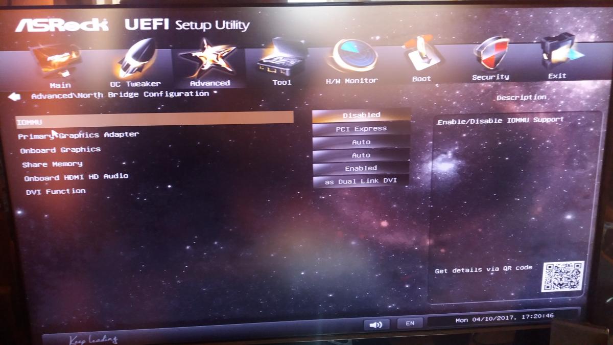

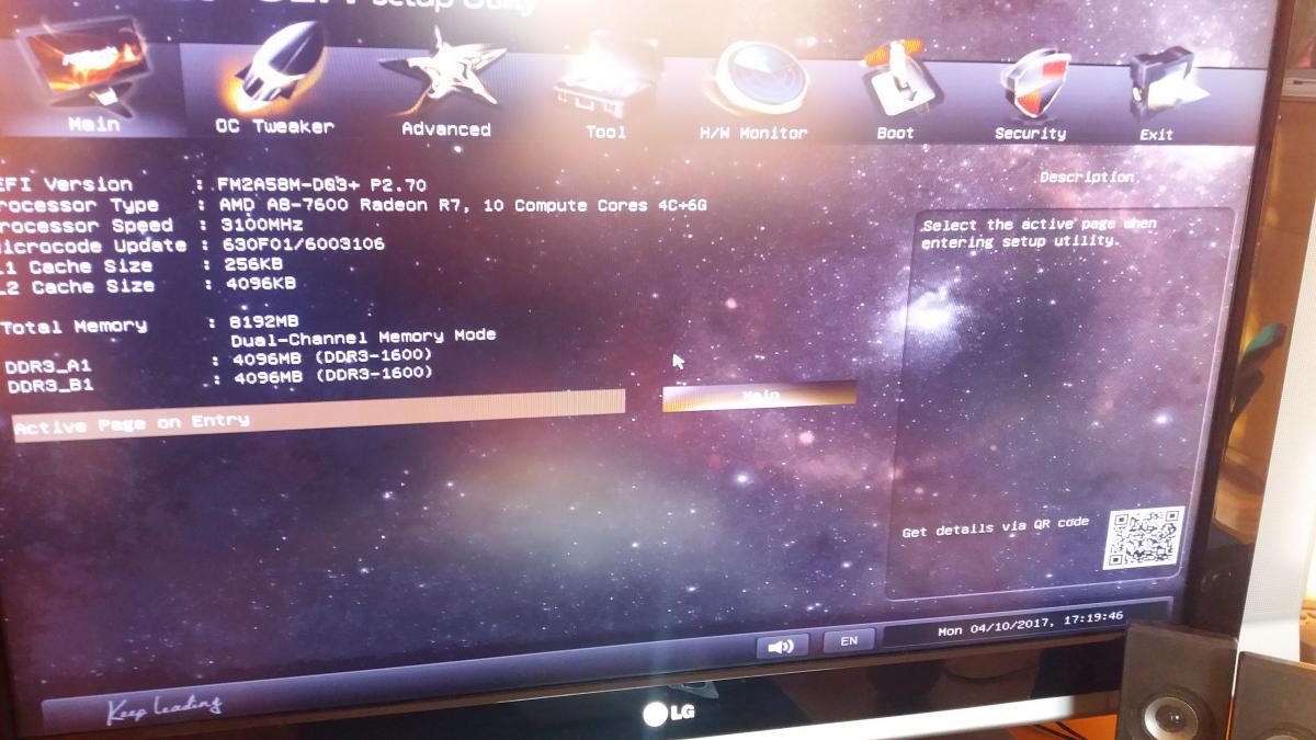

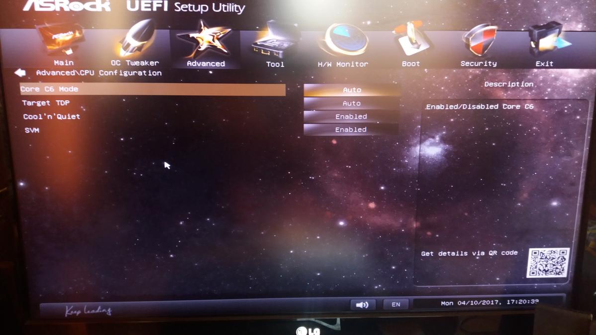

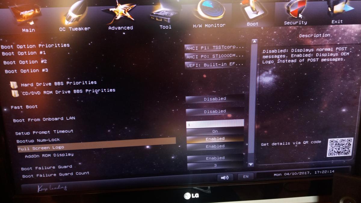

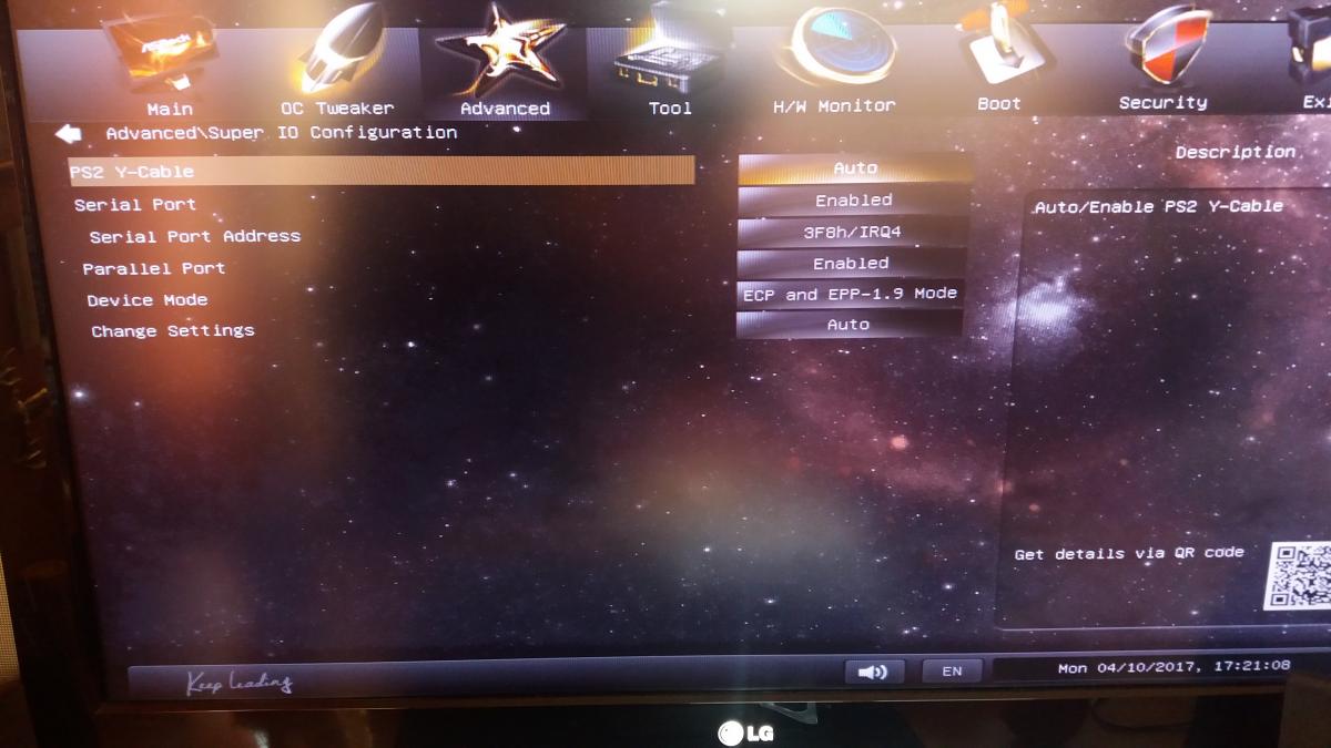

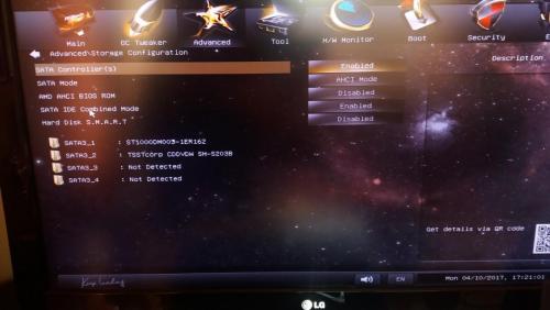

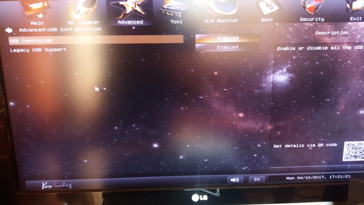

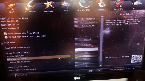

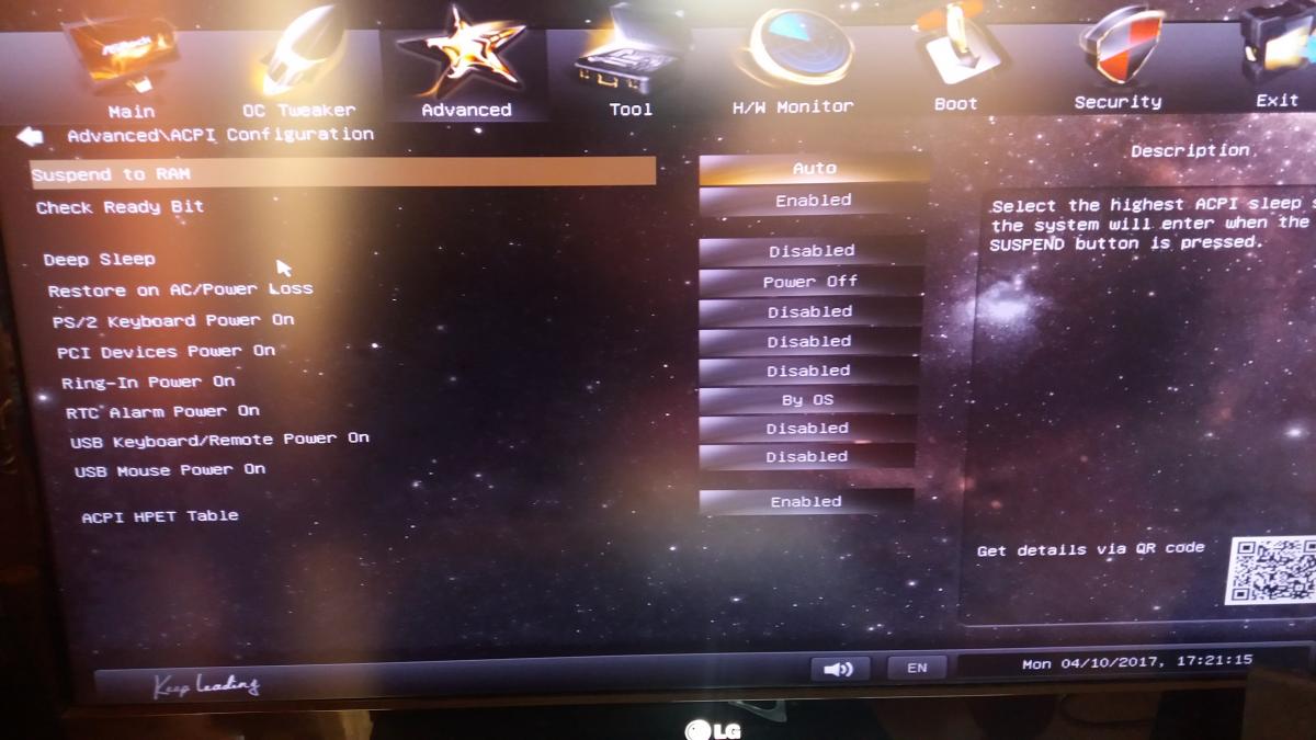

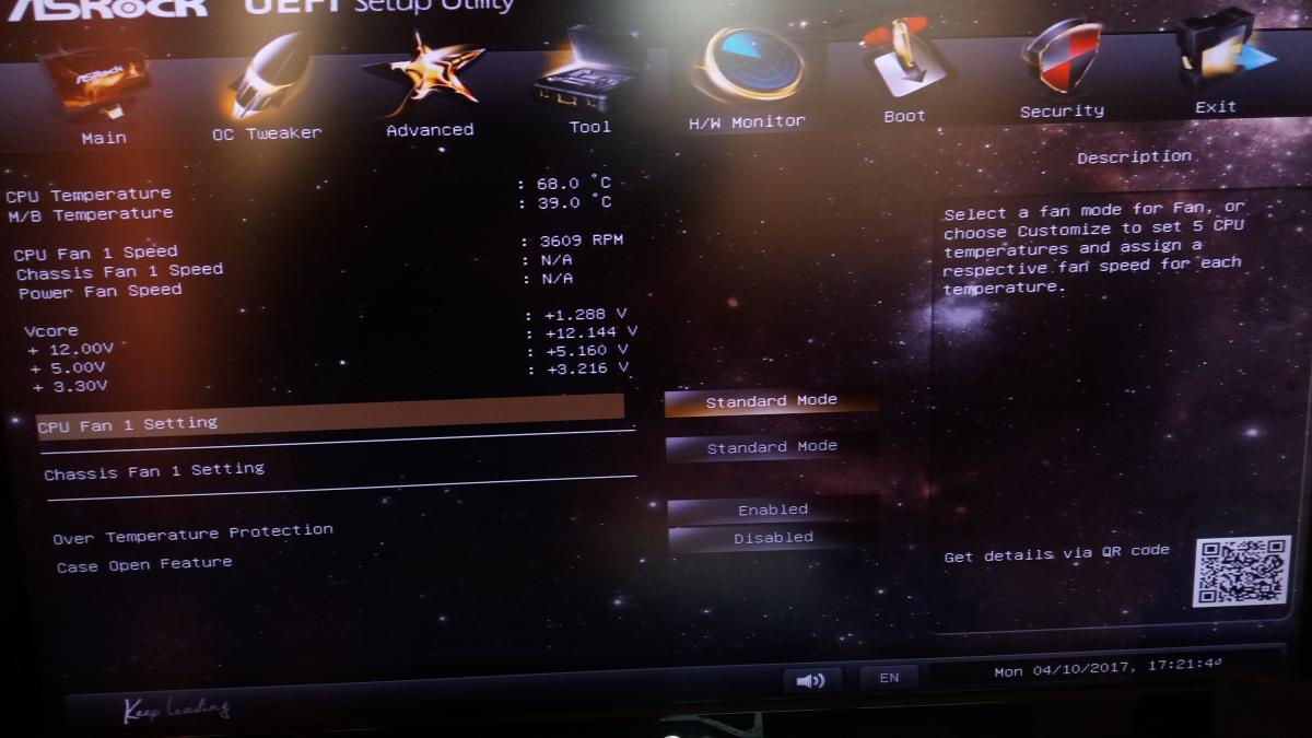

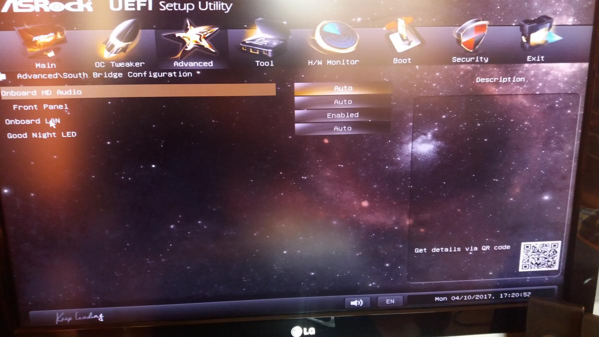

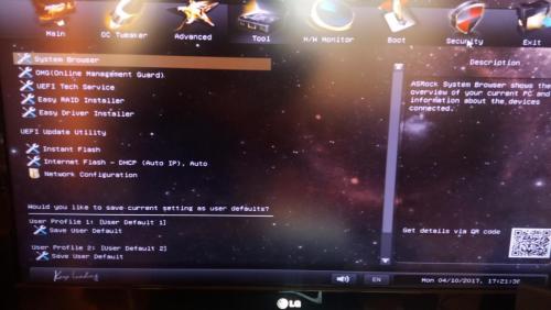

Everything is set to default now but I have made screenshots of almost every BIOS setting, images below:
#75
  • 24,736 posts
Try disabling Cool  n Quiet on the last screen I think that slows things down so it stays cool & quiet.
