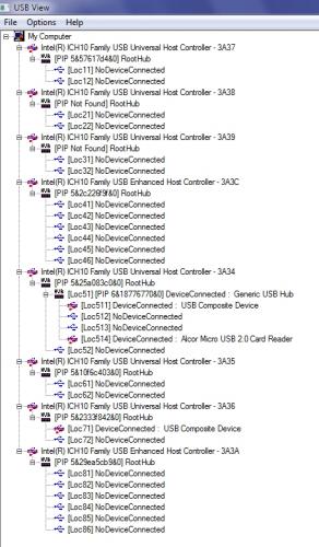

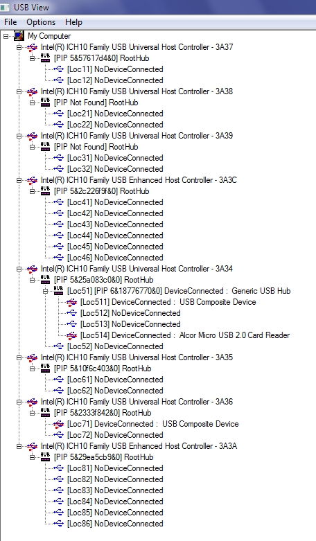

USBView doesn't show Standard OpenHCD/StandardEnhanced PCI to USB Host Controller
PC was bought in 2008, should all be USB 2.0.

I see two Enhanced USB Controllers with nothing plugged in and it looks like you are using an external USB Hub for your connections which is not plugged into one of the Enhanced ports.  Have you tried connecting directly to other USB ports?  Are you sure the external USB hub is 2.0?

Now with USBView open, I plugged a usb drive into both my top usb ports, and saw that they are both showing up in the 3A3C.
And yes, when I connect my scanner via either of the ports on top of my case (which according to usbview are both 3A3C), if I ignore the 'your device can run faster' message, the device runs really slowly, but if I continue reconnecting multiple times, then the device runs at the normal speed.
Btw, when you say USB Hub, I assme you mean some sort of expander hub accessory. I don't own one of these. I'm not using a single USB port to share multiple devices.

Look at loc51.  It appears to be a hub since it shows 511, 512, 513 , 514.  That's what my external hub looks like so there is something in your box which is acting like a hub.  Maybe a card?
