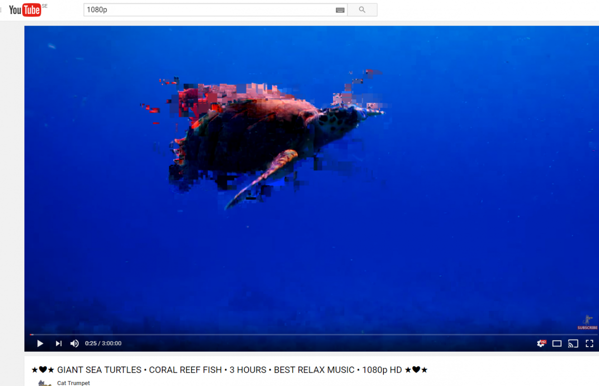

I have recently upgraded my graphics card to ASUS GeForce GTX 1070 Strix Gaming OC 8GB, and ever since I have had problems with videos and streams breaking temporarily and stuttering. The attached file is an example of what it looks like. What is causing this and how is it remedied?

:welcome:   Lorda,
Could be a driver issue but too soon to say without having more to go on;
Is the problem with all videos or only those online.
When you upgraded the card did you uninstall the old video card drivers before installing those for the GTX 1070.
Please provide information about your computer, this includes is it a custom build or brand name such as Dell or HP, if a brand name, provide the model name or series number (not serial) if a custom build post the brand and model name or number for the MB, the RAM (including the amount) and the PSU (power supply unit) providing these details will enable us to better assist you.

The problem is with all vidoes i have tried, both downloaded and online. I did not uninstall any drivers before installing the new ones, however the card installed the new drivers on its own. i have double checked and the drivers are reinstalled and up to date. My computer is a custom build with these specs:

Good quality hardware so looks even more likely to be driver related.
Any old drivers needed to be uninstalled first to avoid conflicts and the drivers for the new card should not have been allowed to auto install, you most often end up with drivers being installed as part of a Windows update and this can cause all sorts of problems, the drivers from the disk that came with the card should have been used.
Download DriverView from nirsoft.net
Run DriverView.
Save the results as a Text File.
Copy/paste the info into your next reply for us.

  • 25,099 posts
✓  Best Answer
Windows has downloaded and installed generic drivers for your video card and not ones specifically provided by ASUS for your card (see below highlighted in red, OEM means original equipment manufacturer) this may not explain the issue but when possible you should always obtain drivers from the hardware manufacturer and not from a third party such as Microsoft or Nvidea, Nvidea made the chip for the card but ASUS tweaked it and provide the drivers intended for it, once you post back to let us know that you have read this update we can move on, don` want to bombard you with too much info all at once;

Lorda
Lorda
  • 6 posts
I cleared the graphics card of the bad drivers and installed the ones on the disc, and it seems to function properly now. Massive thanks for the help my man!
  • 25,099 posts
Glad to hear that all is now well and thank you for letting us know Lorda  :thumbsup:
