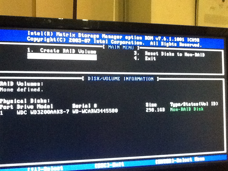

OK good. Go back to main bios screen
Select SATA Mode
Change to AHCI

Sorry it seemed to hang a little, maybe I didn't press the key properly
See photo for current screen

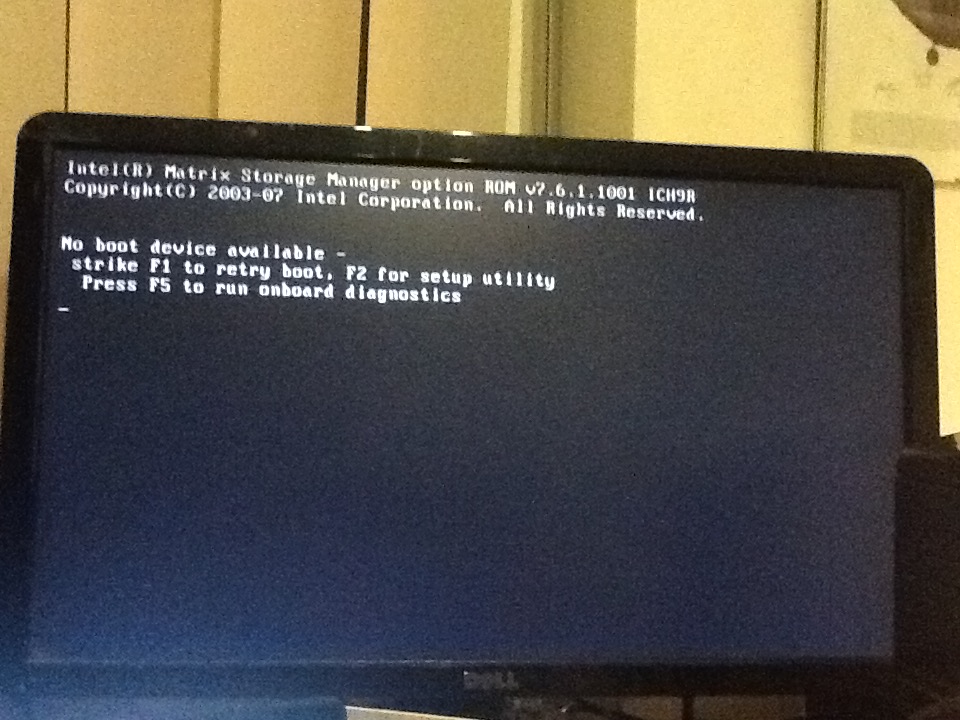

I have no access to SATA mode
jim
#154
dmccoy
dmccoy
    GeekU Junior
  • GeekU Junior
  • 1,295 posts
We need to get back to the main bios screen. Do not hit Ctrl I this time. Look for the system configuration menu, then Sata and you should see option to change from Raid, Ahci etc. Please post a pic me can use either mode and change once Windows is installed

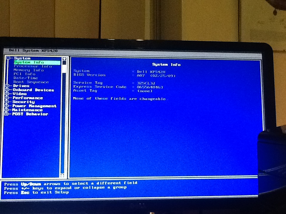

When I hit the esc key it brought me out to this
#157
dmccoy
dmccoy
    GeekU Junior
  • GeekU Junior
  • 1,295 posts
Hit f2 to go back into bios

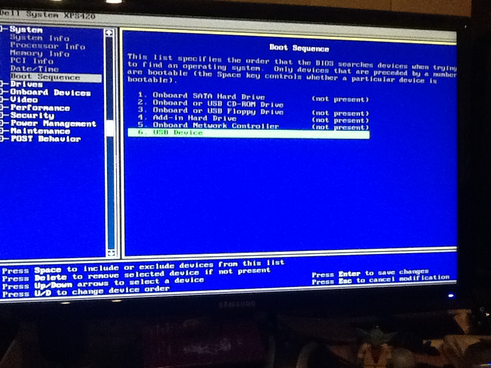

Jb852
Jb852
  • 214 posts
Done

Expand the drives option. Do you see anything about Sata mode?
#160
Jb852
Jb852
  • 214 posts
I have:  diskette drive
SATA 0 - 4
EXTERNAL sata
SATA Operation

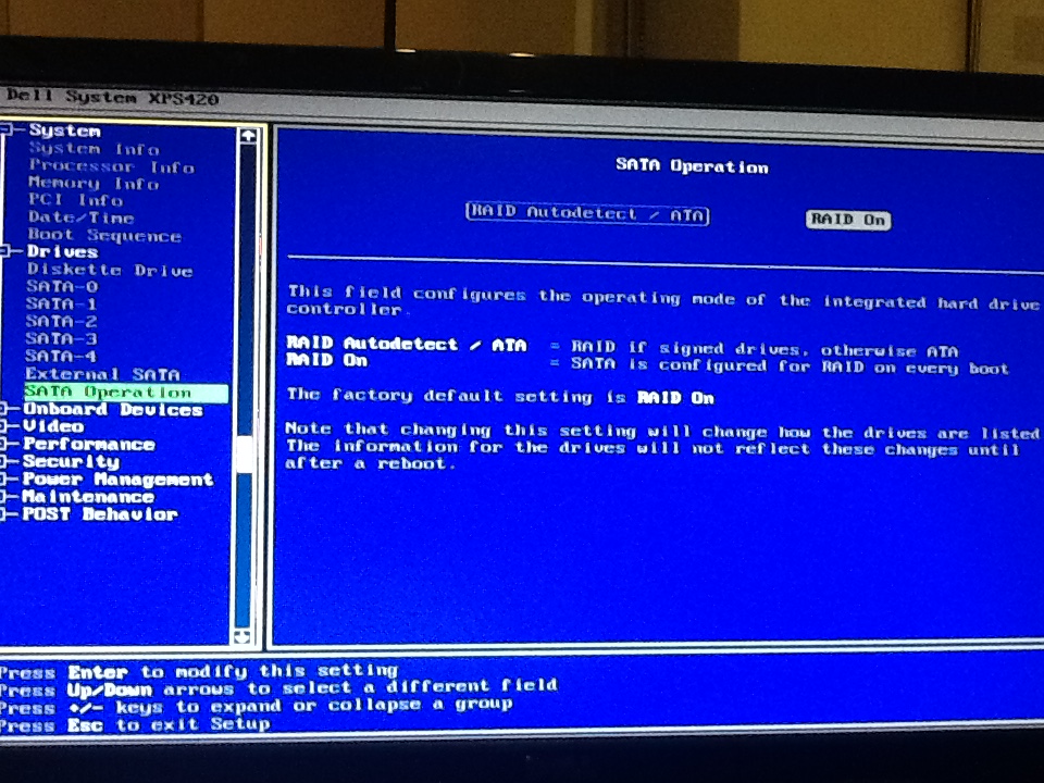

Choose sata operation and show me pic. I think we want it set to RAID Autodetect/ATA
#162
Jb852
Jb852
  • 214 posts
Done

Change to Raid Auto detect and save your settings

#163: done
