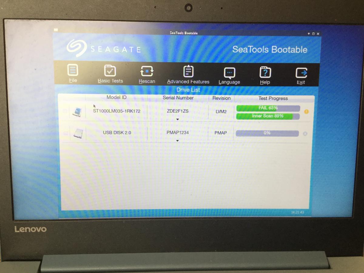

Hi phill,
Its failed the first test on 63%, at least now we know whats wrong with it! Ill have to look at the price of a replacement drive and see if its worth it.

Hello Scott,
That is weird, a loose internal connection perhaps, is the notebook still under warranty, the specs that I get suggest that it may not be that old.
Please run the long test if only to confirm that the drive fails both tests or not, I always like to have a second opinion.
An SSD is the way to go as they have come right down in price, a 250GB SSD and if needed further down the line invest in an external USB HDD.

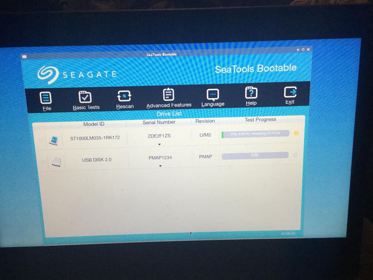

Hi Phill,
Ill give it a go at getting it repaired. It was PC World it was bought from, not sure how receptive theyll be? They might try and say it was dropped or our fault it was damaged?
Thats the crucial one I was looking at also but the 250gb one. I suppose for the price the 500 is probably better value.
The long scan hasnt failed yet but it has been sitting on 2.99% with 3:25:43 time left to go for about 40 minutes!

  • 25,137 posts
Hi Scott,
Be insistent with them and especially if the notebook is unmarked and has in fact never been dropped or banged, Seagate HDDs are on the avoid list nowadays as their quality and reliability is not what it used to be.
It might be an idea to leave the long test running overnight, even then it may not complete, the HDD testing information will be good to have when it come to dealing with PC World, unless things have changed they don`t have fully qualified instore techs so will need to send the notebook back to their workshops to be checked out, at the end of the day if the notebook just out of the blue failed to boot the notebook is not fit for purpose.

Hi phill,
Just a wee update, the long scan has now been running over 24hrs. It’s moved to 3% but now says it has over 18hrs to run. This has been like this since I checked it this morning and has never moved.
