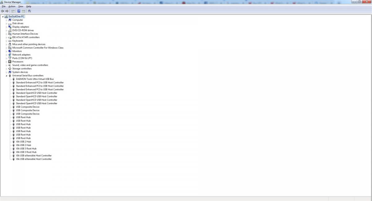

Can you do the following, take a screenshot and then upload it for us.
Open the Device Manager.
In the "Device Manager" window, click the + (plus sign) next to Universal Serial Bus controllers.
Grab a screenshot for us if you will.

Sorry for the delay. As requested, the screenshot.
  • 25,117 posts
You can see for yourself that both USB 2 and 3 are listed which either means that as previously mentioned the info at the MSI link is incorrect or alternatively that there is a different revision of the MSI 970 Gaming MB that you have.
