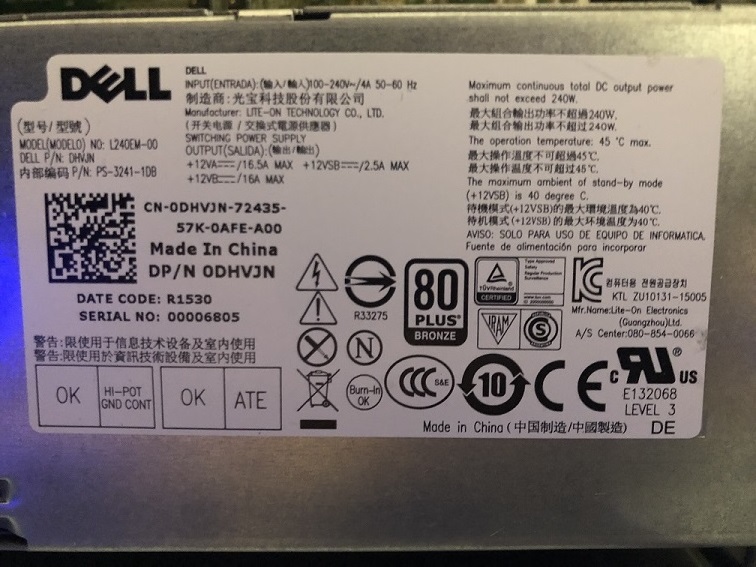

If the computer is a desktop can you post the brand and model name or number of the power supply (PSU).

  • 24,786 posts
We can see a few things going on but will address the one that could be causing the shut downs first.
There are both weak and high voltages showing which would explain the behaviour, no way should Dell have shipped these computers with an add on GPU but only a 240W PSU and a cheap Chinese one at that.
Suggestion, try removing the add on video card from the motherboard and connecting your screen to the appropriate video port on the MB, reassemble, power up, test then post back with an update for us.
Voltage
CPU CORE: 1.696 V
MEMORY CONTROLLER: 1.664 V
+3.3V: 2.976 V
+5V: 5.000 V
+12V: 11.392 V
+5V HIGH THRESHOLD: 4.059 V

Thank you.
Yes this is the PSU that was supplied with the PC, i know very little about hardware or software TBH but i'm pretty certain aftermarket higher powered ones are nigh on impossible to find, same with the motherboard.
I havent altered it from the way it came when i bought it
Ps. I had 2 frozen screens even trying to reply to this topic, that's before i took the graphics card out

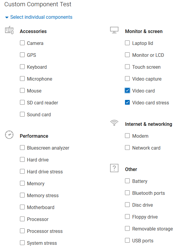

  • 24,786 posts
See if you are able to run the built in Dell Diagnostic Tools, info here
Retiring for the evening now but will check back asap tomorrow

Just a quick update, it's freezing when trying to run the Dell Diagnostic tool, i'm starting to think my processor is fried?
When i rang the ever so helpful Dell people after the BIOS update goofed my PC up they mentioned, i think, a voltage surge may have damaged my motherboard? Could have affected the processor too maybe & as said i replaced a hard drive too.
I'll try the diagnostic tool again

It froze again on the Dell tool, both times at the 'Fixed Transformation and Lighting Test', 48% & 44%

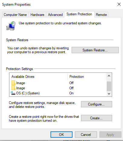

Easiest to do first, create a new system restore point, download and install the Intel UHD Graphics Driver from here re run the Dell diagnostic tool but this time just test the graphics.
When you post back with an update, can you also let us know if the power on button has been blinking at all.
gpl98a1
gpl98a1
  • 201 posts
I've created a restore point as per the attached screenshot, it just allowed me to create it for 1 hard drive

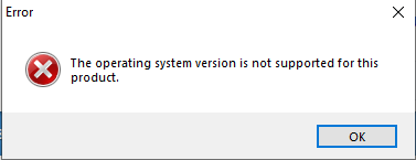

I then went download the Intel UHD Graphics Driver but it won't let me install it. A notepad txt file appeared which i have attached - sorry if this is extra information but i thought you needed to know
