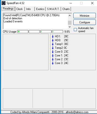

Download Speedfan and install it.  Once it's installed, run the program and post here the information it shows.  The information I want you to post is the stuff that is circled in the example picture I have attached.

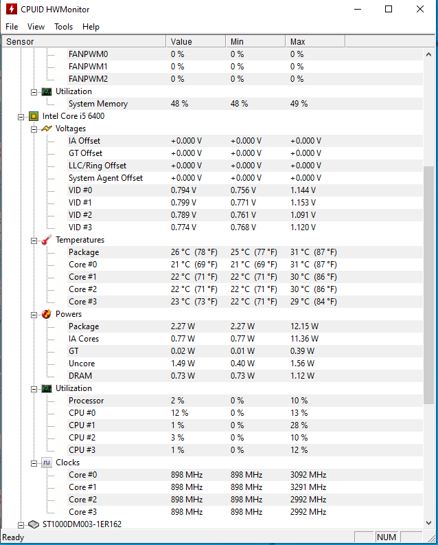

So that we have a comparison to Speedfan, download, run and grab a screenshot of HWMonitor (free).

Strange, just before you posted your reply the cooling fan went mad & started running at full speed, had to shut off with the power button
This is all the info Speedfan was displaying

No signs of overheating but those bad voltages are again present.

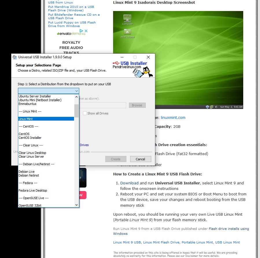

While I type a reply I have a suggestion for you to try meanwhile, try booting from Linux on a USB thumb drive and see how that goes, see info here

Ok, im not too clear on this Linux bit, is it Linux Mint i'm installing to the pen drive?
I can see Linux Lite, Linux XP lite & 2 under a heading 'Clear Linux'
My 'broadband' only runs 4.5mb/s so it may take a while, fibre isn't available to me at the minute

Mint will do  :thumbsup:

I created a Linux USB boot, booted from it approx 5 times but it froze every time, max 3 mins on it when opening the firefox browser to post on here
