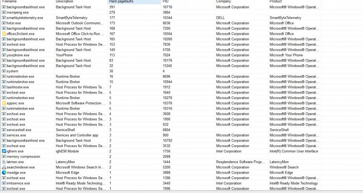

LatencyMon scan #2 after OOSU10 reboot:

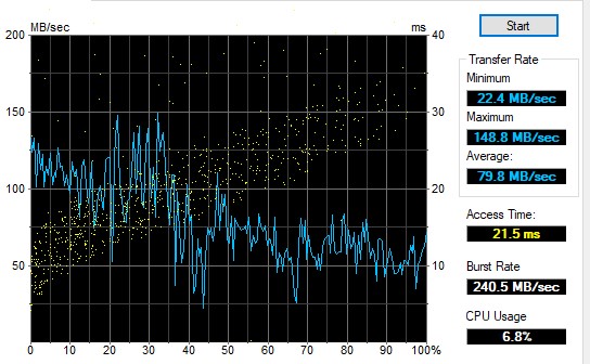

  • 94 posts
HD Tune scan:
  • 24,748 posts
How long did you let Latency Monitor run?  The processes screenshot looks really ugly but if it ran for a long time that might be OK.
Can you do it again for just 20 seconds?

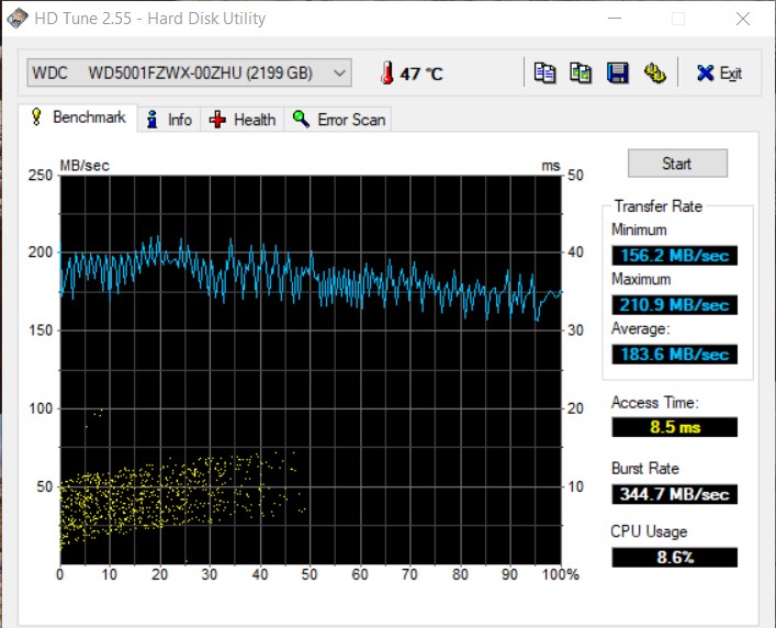

This is what a really good hard drive (Western Digital Black) looks in HD Tune:
hdtunewd.jpg so you may need a new drive in the near future.

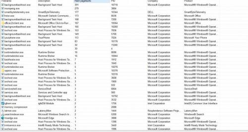

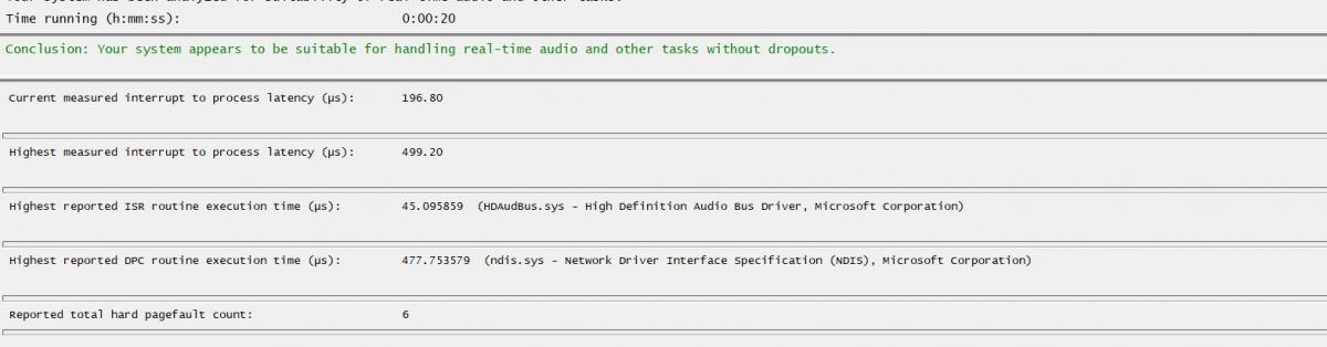

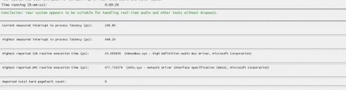

  • 94 posts
LatencyMod for 20 seconds:
  • 24,748 posts
Did you get a screenshot of the Processes page this time?  This time we only got 6 page faults which isn't too bad tho I would prefer zero since each time you get a page fault the CPU has to stop what it is doing and write stuff to the hard drive then go back and read the stuff so it takes some time and slows thing down.

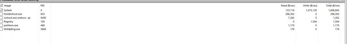

  • 94 posts
Disk screenshot: (task manager)
Edited by Warship, 16 October 2021 - 05:12 PM.
  • 24,748 posts
Lot of activity from System.  Go to Settings, Update & Security and Check for Updates.  If it finds an update let it install it then it will probably reboot.  Check for Updates again as often one update requires a second update.

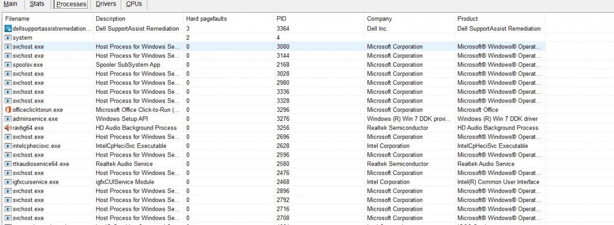

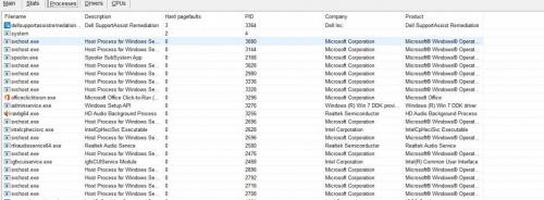

  • 94 posts
LatencyMod 20 second Processes:

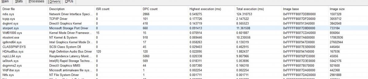

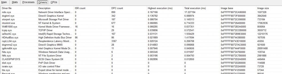

  • 94 posts
LatencyMod Drivers:
Warship
Warship
  • 94 posts
I checked for updates and it updated a very small one but did not reboot. My computer completed a big update day before yesterday and did reboot.
  • 24,748 posts
Dell has several driver updates for your PC.  Some of them are marked urgent and some are very new.  Go to:
https://www.dell.com...desktop/drivers
See if you can update the
Qualcomm QCA61x4A/QCA9377 Wi-Fi and Bluetooth Driver
Intel Graphics Command Center Application
Intel Rapid Storage Technology Driver
It won't hurt to update any of the others but these three are critical.
When done rerun Latency Monitor and post the summary  and screen shots of the Processes and Drivers tabs.

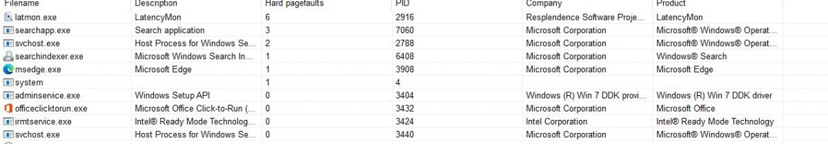

  • 94 posts
LatencyMod Processes for exactly 20 sec. Incidentally, the computer seems MUCH faster than it has in months. By the way, something odd happened when I was downloading those drivers. I chose to download all 5. It was proceeding normally until it got to about 40% completion. At that time, I lost my internet connection (it wasn't my provider either) and I got an error message saying "Download Failed." I waited for a while and then i rebooted. I still had no connection and I had to manually reconnect but was able to. I returned to the Dell page and checked for updates to retry and it reported there were none and that my system was fully updated. Not sure what to make of all of that.
Edited by Warship, 17 October 2021 - 02:22 PM.

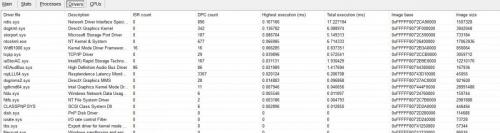

  • 94 posts
LatencyMod Drivers for exactly 20 sec.
