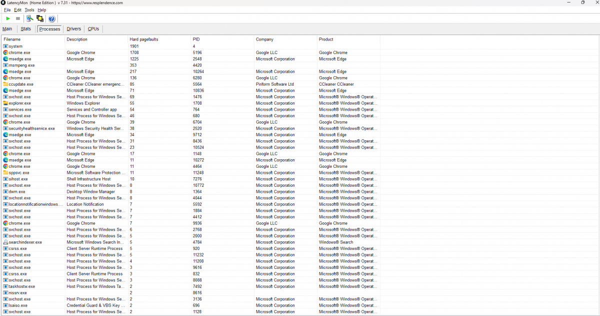

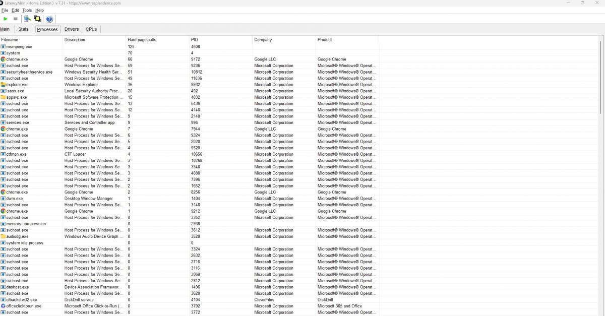

Theses were the screen shots for Drivers and Processes.
I've increased the Virtual Memory to 16000 and ran the memory diagnostics which said did not find any errors but didnt produce the report when restarted.
Since I changed the virtual memory start up appears faster at 4 mins from switch on to search results delivered

CCleaner is part of the problem so uninstall it.  We certainly don't need it.
Let's see if we can keep Edge from running. since you are using Chrome.

Reboot and repeat the Latency Monitor running while first trying to bring up Chrome test and post the Processes tab screenshot.

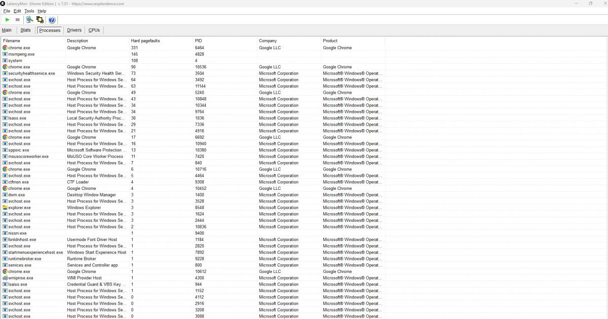

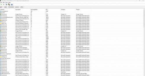

I've uninstalled CCleaner and followed the instructions for Edge. In task scheduler I have disabled the two Edge tasks,and also the one dive tasks and windows defender. There was nothing that I could see in the start up tab as it only shows two enabled Mobile Devices- I'm not sure if I should disable that one  as it says the impact in not measured and the windows security notification icon is enabled but says Low Impact.. I've attached the Processes screen print  and the PC took 3:40 from start up to results from a google search and that was with the Latency Monitor running at the same time.
I've gone into the BIOS and says the version is R01-C3 and a google search says that for my model Aspire XC-885 this is the most up to date version

Rerun Latency Monitor and post the summary and a screenshot of the Processes tab.

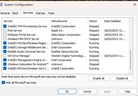

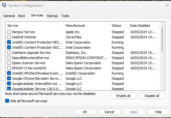

You might also try searching for
msconfig
and hit Enter
Click on the Services tab,  Check the box to hide Microsoft services and then uncheck everything that remains.  Apply and reboot.  IF it makes a big difference then go back into msconfig and recheck about 1/2 of the things you unchecked.  Try and isolate it to one or two services.  If no big difference then recheck all.

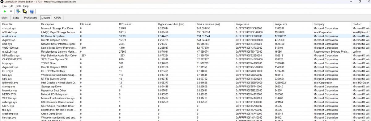

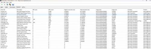

Just working my way though your instructions, here is the Latency Report and I've attached the screenprint:
CONCLUSION

 REPORTED ISRs
Highest ISR routine execution time (µs):              51.402066
Driver with highest ISR routine execution time:       Wdf01000.sys - Kernel Mode Driver Framework Runtime, Microsoft Corporation
Highest reported total ISR routine time (%):          0.001825
Driver with highest ISR total time:                   HDAudBus.sys - High Definition Audio Bus Driver, Microsoft Corporation
Total time spent in ISRs (%)                          0.002328
ISR count (execution time <250 µs):                   1012
REPORTED DPCs
Highest DPC routine execution time (µs):              388.823362
Driver with highest DPC routine execution time:       dxgkrnl.sys - DirectX Graphics Kernel, Microsoft Corporation
Highest reported total DPC routine time (%):          0.024699
Driver with highest DPC total execution time:         storport.sys - Microsoft Storage Port Driver, Microsoft Corporation
Total time spent in DPCs (%)                          0.093193
DPC count (execution time <250 µs):                   48314
DPC count (execution time 500-10000 µs):              2
 REPORTED HARD PAGEFAULTS
Process with highest pagefault count:                 chrome.exe
Total number of hard pagefaults                       1436
Hard pagefault count of hardest hit process:          331
Number of processes hit:                              39

I have run the avast uninstaller and disabled all of the services apart from Microsoft and did a restart and it was much faster, from power on to search results delivered took 2 mins 17 secs,
Do you mean to recheck the services I disabled until it slows the machine down again? sorry to be a bit thick :)
Edited by Steviep, 17 May 2024 - 06:12 AM.

  • 24,731 posts
Yes.  We want to find out what program(s) is/are at fault.

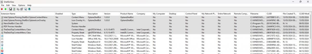

Also the DxDiag is complaining about Unlock.exe which is apparently associated with your Western Digital drive.  I am wondering if it will boot faster if you disconnect the drive.
It also reports problems with Explorer.  These are usually caused by third party addons.  Get
ShellExView.
Use this download:
Once you get it installed, run it and look in the third or fourth column from the RIGHT. It should say MICROSOFT. Click once or twice on MICROSOFT so that items with NO are at the top.
Select all of the NO items and then click on the red led looking icon in the upper left. This should disable all of the non-microsoft additions to Explorer. Reboot and see if that helps any with the speed.

Hi, I've run through Services and the ones that are unchecked seem to slow the PC down.  With the services as they are at the moment it takes around 3 min10 from switching on until search results are obtained, which is much better than where we were. One thing I have noticed is that I get the Acer screen for 30 seconds and then the screen goes completely blank for the next 1 min 20 secs before log in page shows

I have disconnected the drive, I dont normally leave it connected but had been using it, I dowlnloaded the software and ran it but didnt really note any difference in the speed, I did notice that one of the items related to Nero- I used to have this on the PC but removed it ages ago

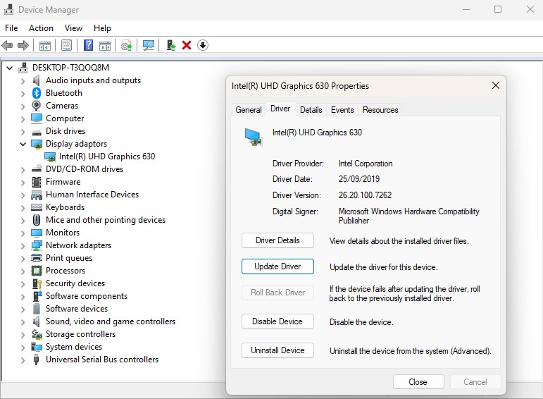

Rereading your previous post about the long delay between ACER and the login.  That sounds like a problem setting up the display adapter.  Have we tried a different driver?
You are using 23.20.0016.4973
There is one on the Intel site that might work and it is 31.0.191.2127
https://www.intel.co...cs-windows.html

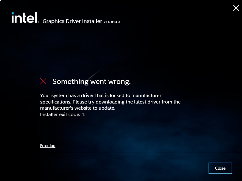

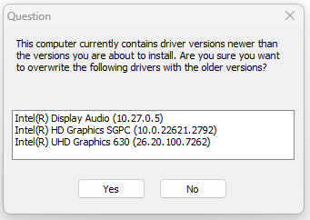

I tried updating the driver and got the message in the first attachment, I then uninstalled the adapter and did a restart, however the same one has been installed again, see 2nd attachment

Curses.  There is a newer version on Acer's support website.  You can try it tho Acer doesn't support Win 11 on your PC:
https://www.acer.com...uggest=XC-885;0
You have to scroll down to the bottom and then Load More.  Look for the VGA Driver from intel.  You want the one that says
26.20.100.6911
There is also the possibility that removing the old driver first might allow the new intel driver to install:
https://www.intel.co...n install guide

Steviep
Steviep
  • 420 posts
I downloaded the driver from the Acer site and when going to install I'm getting the question in the attachment
