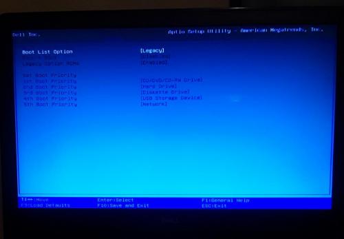

Hi Anna,
That picture shows that the BIOS has the computer set to boot from a network device, go into the BIOS and make sure that the DVD drive is first and the HDD second in the boot order, the PXE device should not be enabled as a boot option in the BIOS, if it is please disable it, save the settings and exit.

Hi Phill,
I do have it set to DVD first, in Legacy. There is no option for DVD in UEFI.  I don't know what a PXE device is.

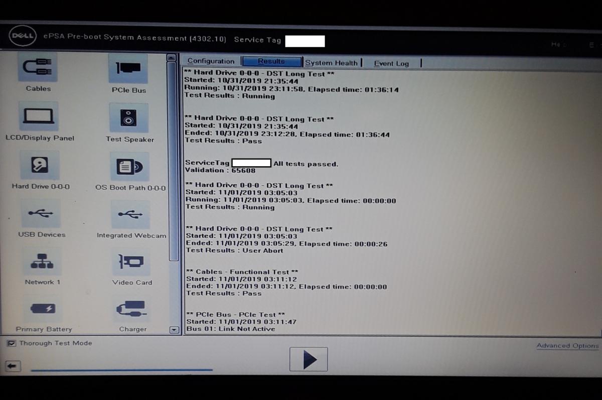

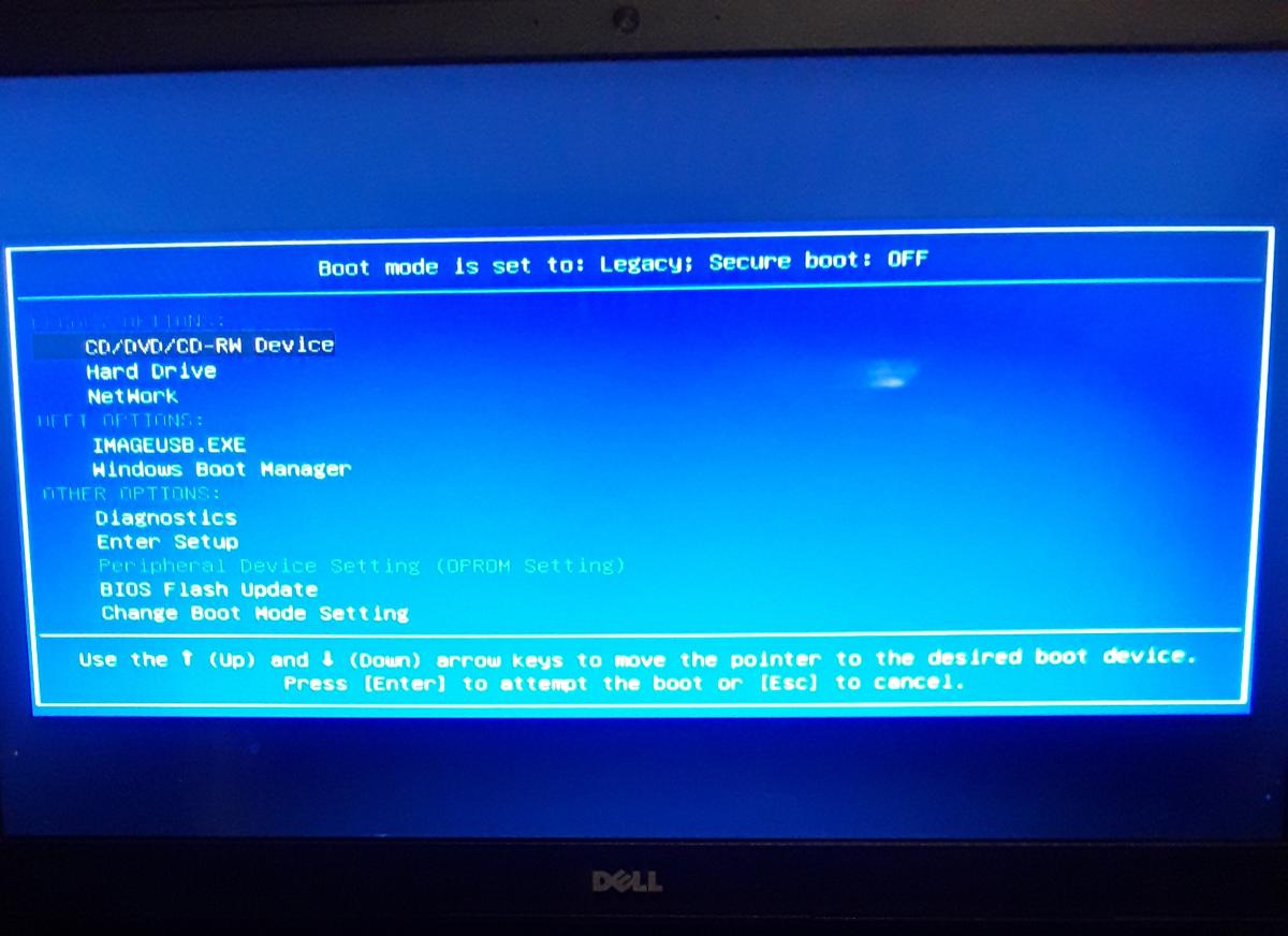

Hello Anna,
Quick question, we can see the option to run a diagnostics in your third screenshot, can I ask what if anything happens if you select the option.
PXE is the option to boot from a network as is shown to be the 5th boot device option in your first screenshot, the fact that you got the boot error as is shown in your reply #75 normally means one of two things, no boot device/media found or the computer has been set to boot from a Network when it has not been set up to do so.

Hi Phill,
I'd already tried Diagnostics. See post #44. It took me to the ePSA Pre-boot System Assessment.

Hi Phill,
Today, the display is normal. I ran all the Diagnostics tests on everything listed in the left pane. All have come back as Passed. I took pics of all the screens, so if there is something you would like to see, just ask and I will post it.
#82
  • 24,780 posts
Hello Anna,
Thanks for the screenshot which suggests that the HDD is ok.

I don't have a Network, never set one up, so don't know how PXE is on my laptop.
Overlooked answering this, the Network is on the BIOS chip and is not installed by the end user, what can happen sometimes for one reason or another is the BIOS gets changed and the option to boot from a Network gets enabled.
