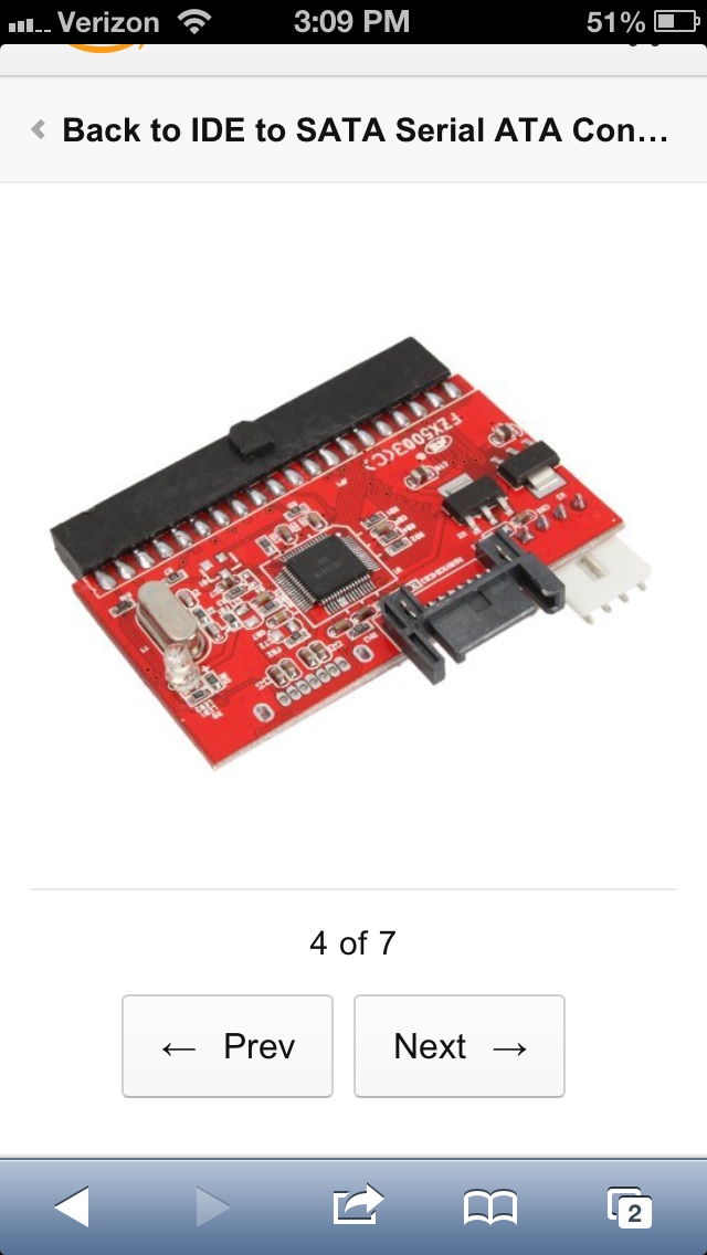

I have not installed any additional video cards, and I don't know if the factory installation uses a slot (don't believe so). I do have a card in one of the PCI slots that adapts an older IDE hard drive I had to SATA on this system. It's been running fine as far as I know. The system has been up and running in safe mode for 24 hours now.

Sorry, it's not in a PCI slot, it's a small card mounted on the old drive
#74
groch
groch
  • 180 posts
Looks like this

OK so it is something in normal mode that is causing the crashes
Darn this is a difficult one to track down
How long in normal mode before it crashes ?
