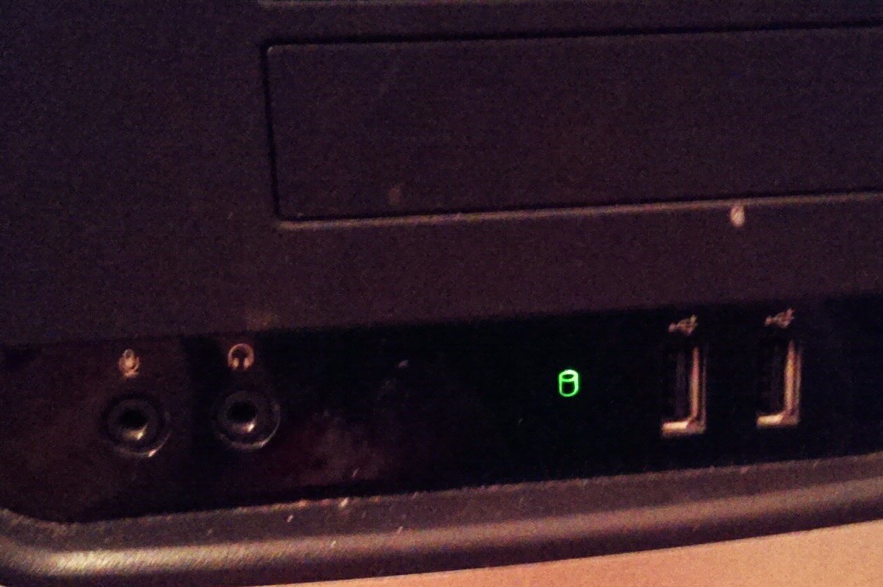

Gday.
I know this is frustratingly slow, but please resist the temptation to do your own thing as stated in reply #175, just do the steps as instructed.
Let's see what happens if we move away from the repair screen.
With only the kb plugged into the USB ports.
No cd of any kind in the optical drives. (check both)
Restart the computer and report on the following.
Whatch the HDD activity LED, (see screenshot) does it flicker or light at any time?
is there a light on the kb?
What is displayed on the screen?
Are any diagnostic lights lit?
Have you managed to purchase a battery yet?
#178
Lexy610
Lexy610
  • 743 posts
Ok my apologies ..
Nothing in either of the cd-roms .. checked them both. Only kb usb is plugged to tower.
The tower had the number flashing when first turned on but now there are no numbers flashing BUT there is a flashing icon which appears to look like a cylinder .. its green and it was flashing really quickly now its flashing slowly on and off.
kb lights are on.
my windows desktop is on the screen now.
no diagnostics lights (no numbers) just that cylinder like flashing on and off slowly.
No I have not been able to go out and purchase a battery as of yet. Maybe tomorrow since I get off of work early. One question tho .. when I go purchase the battery for my tower .. is there a particular battery?? How will I know which to buy or if its the right one?

Hello I was just able to add a pic to that post of what I was describing. I have to shut down for the night and I just looked at my tower that is no longer flashing .. dont know when it stopped but it flashed for a while when I first turned on computer.
