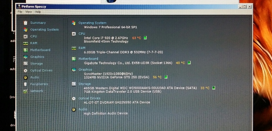

oh... pc is custom built.. i told them... and im embarrased by this.. but i wanna raid in wow without lag.. and the dude was a gamer.. so he built it... but.. as ive come to find out.. in this move across province.. ive lost all the discs to my different components ugh
You can download and install Speccy (free version). Then execute it, take a picture of the main window and post it here Chicklet.

#102
Posted 30 July 2014 - 06:42 PM
ok i downloaded it.. how exactly do i execute it... its a lil confusing
#103
Posted 30 July 2014 - 06:43 PM
Executing a file simply means to launch it (double click on it)
#104
Posted 30 July 2014 - 06:50 PM
#105
Posted 30 July 2014 - 06:53 PM
Your CPU is overheating. I strongly suggest you to clean the inside of your computer case. The trick is to get a can of compressed air, then blow the dust out of the case (remove the side panel the access the interior), and you aim for the CPU, GPU, fans and cooling system. Also, reapplying thermal paste on the CPU will be a good idea.
