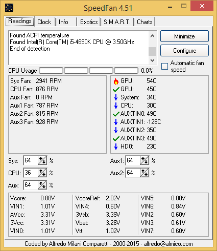

All appears as it should be with your cooling and Ram, do you have an option in the BIOS to restore the MBs default factory settings (sometimes listed as "most stable") if yes, have you tried the option.
Before looking at drivers can you check your temps and voltages for us please;
Download Speedfan and install it.  Once it's installed, run the program and post here the information it shows.  The information I want you to post is the stuff that is circled in the example picture I have attached.

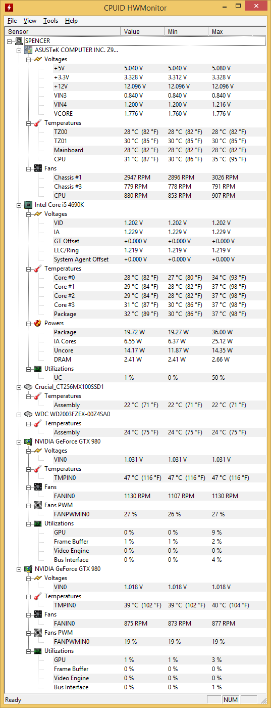

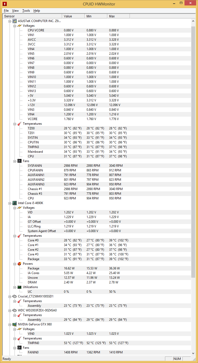

  • 24,638 posts
In the main everything looks good both temp and voltage wise but I can only see the temp for the one GPU which seems quite hot for a card that is not under load, can you scroll the HWMonitor results down and attach the bottom of the page as a screenshot for us please, incidentally, if you check the temp details below you will note the safe temps for a single card, full article here
Some info below for testing the card/s to see how hot they do get under load.
Temperatures During Gaming Loop - Open Bench -Table Closed Case - VRM
Gigabyte GTX 980 Windforce OC      60-61 °C         64-65 °C              93 °C
Put your video card/s through their paces with Valley Benchmark (free) which you can download from here post back with an update for us when you are ready.

  • 149 posts
Yes I have ran valley multiple times becasue I did at first think that maybe my gpu overheating was causing a crash, in games the highest I would see the temp get on gpu 1 would be 80ºC and around 70ºC for GPU 2. I have also ran valley a few times with the same results, and from what I read when you do run SLI the cards tend to get warmer then when running a single GPU.

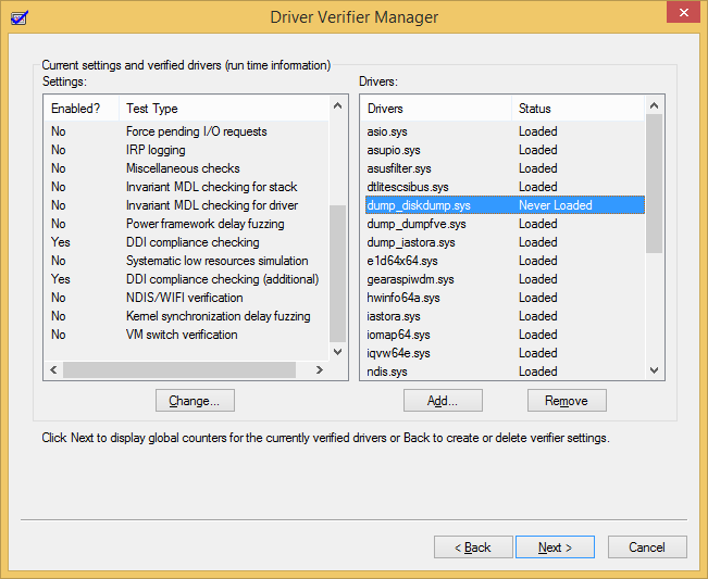

  • 149 posts
Ok this is now running.  I did not have an option for concurrency stress test.  Also when checking to the verifier it says dump_dumpfve.sys is never loaded.  Is this important?  Also what if my computer freezes at some point during this or something causes my computer to shutdown do i need to restart the verifier?  I will post back in a few days if there was no problem.dvm.png
  • 24,638 posts
Ensure that crash dumps are enabled on your computer, details for this here
If the computer does crash DV will hopefully identify the driver for us, freezes are more difficult to deal with as they can be hardware as opposed to software related.
DV will keep on running on your machine until you disable it and no restart is required after a crash.
