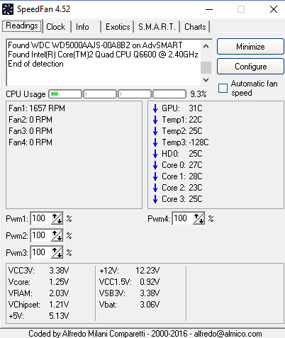

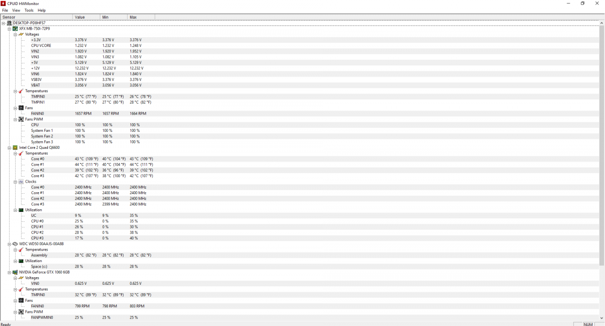

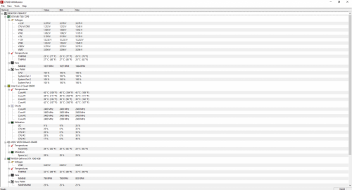

There is all of them in order.

  • 25,141 posts
Your temps are all very good now and with the exception of possibly the RAM so are the voltages, below are some quotes from your thread;
I am getting screenshots now. I will try to do it after gaming but it may freeze. Also, i hear 4 beeps when my pc turns on
Four short beeps: System timer failure
One of the timers used for controlling motherboard system functions has an error. There's either a failure of the motherboard or one of the devices on the motherboard.
Will wait on the screenshots for now but just so that you are aware 4 beeps can also mean a problem with the RAM which can also be associated with a MB device failure, a memory slot as just one example.

Your RAM being DDR2 means that it is quite possibly 1.8V but if you look at the HWMonitor readings you will see that the VIN voltages 2 and 6 exceed 1.8V and VIN3 is way below 1.8V, we need to know the following;
The brand and model name or number of the RAM.
How many sticks of RAM you have and what slots the RAM sticks are in on your motherboard.
