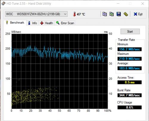

See if you can get HD Tune to run:
https://www.lifewire...-review-2624561
Actual download is at:
http://www.hdtune.co.../hdtune_255.exe
Download, Save, right click and Run As Admin.  Run the Benchmark test and report your min, max & average transfer times.  Ideally the graph would be flat or slightly tilted to the right.  On a bad drive you will see sharp drops.  The fewer programs running at the same time the better.  Pause your anti-virus.
This is from my secondary WD internal drive:
Being attached via USB your drives will be much slower.
HD Tune also has a Health tab which on some versions will show SMART info.  Does it work on yours?
