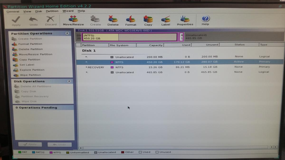

I burned the pwhe42.iso to a DVD and I had to change from AHCI to Native IDE to be able to boot from CD/DVD. I followed the instructions and converted my HDD from Dynamic to Basic. Here's a look of my HDD inside the Partition Wizard program after a reboot:
What's the next step from here?

What happens now when you try to boot?
#53
kajari
kajari
  • 30 posts
The same as ever. Windows logo starts to animate but gets stuck and immediate reboot.

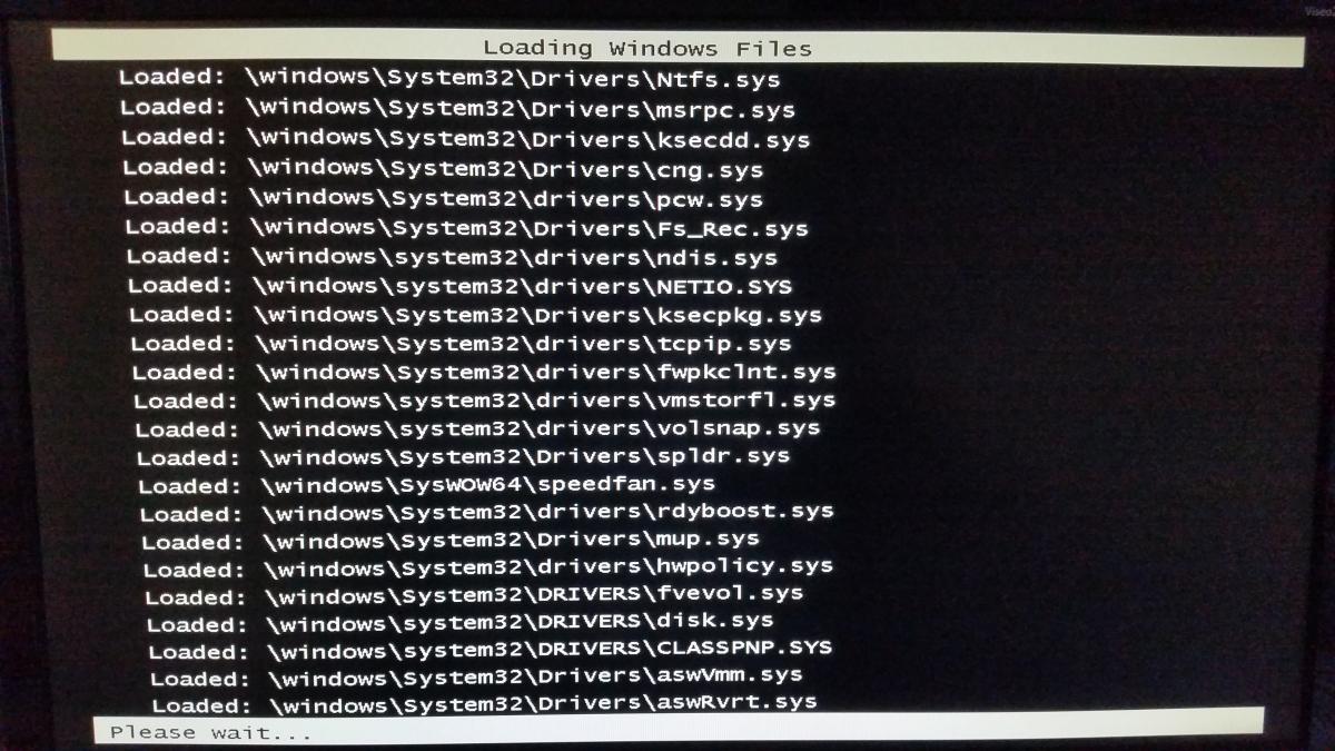

Press the Try first the Disable automatic restart on system failure on next screen select Windows 7, if you get a BSOD post the error code and if available any reference to a file name
Here's the BSOD code and also a picture of it:
*** STOP: 0x0000007B (0xFFFFF880009A9928, 0xFFFFFFFFC0000034, 0x0000000000000000, 0x0000000000000000)
Last listed filename before reboot is aswRvrt.sys

#56
SleepyDude
SleepyDude
  • 4,991 posts
Change the BIOS to AHCI mode to see if the system can boot that way.
If the SATA mode is changed to something different after the windows installation it usually results in a 7B BSOD.

I changed the SATA mode from Native IDE back to AHCI. My listed boot devices are once again only USB:Generic drives such as USB SD Reader. If I try to boot regularly I end up with a screen saying Reboot and Select proper Boot device or Insert Boot Media in selected Boot device and press a key. I can't even get to the Advanced Boot Options.
#58
SleepyDude
SleepyDude
  • 4,991 posts
✓  Best Answer
According with image you posted the OnChip SATA type option on the BIOS can have other values RAID, Legacy IDE, IDE -> AHCI try them all see if any of those option allow you to have the HDD as 1st boot device and result in a boot without the Blue Screen.
I tried what you suggested and managed to boot my computer with IDE->AHCI option!
However I noticed something that I had forgot. When this error first occured I tried to use a backup from my external HDD. I have apparently named my desktop and laptop exactly the same. It seems that I tried to recover my computer from my laptop backup... I logged in on my DESKTOP with my LAPTOP account and password. Also my start menu, programs and pretty much everything is like my laptop was around a year ago. That explains why my 1TB HDD was shown as around 450GB because my laptop HDD is 500GB. It seems that all my settings are my laptop settings all over the computer. I feel so terrible and stupid now.. Was this all in vain? I'm guessing there's no way to get back the desktop as if I understand correctly the laptop image must've overwritten my hdd? If this really is the case then say the words and I'll just install a new OS clean, probably Ubuntu 14.04.3 LTS to try something new and maybe get a VirtualBox and put Windows 10 there...
