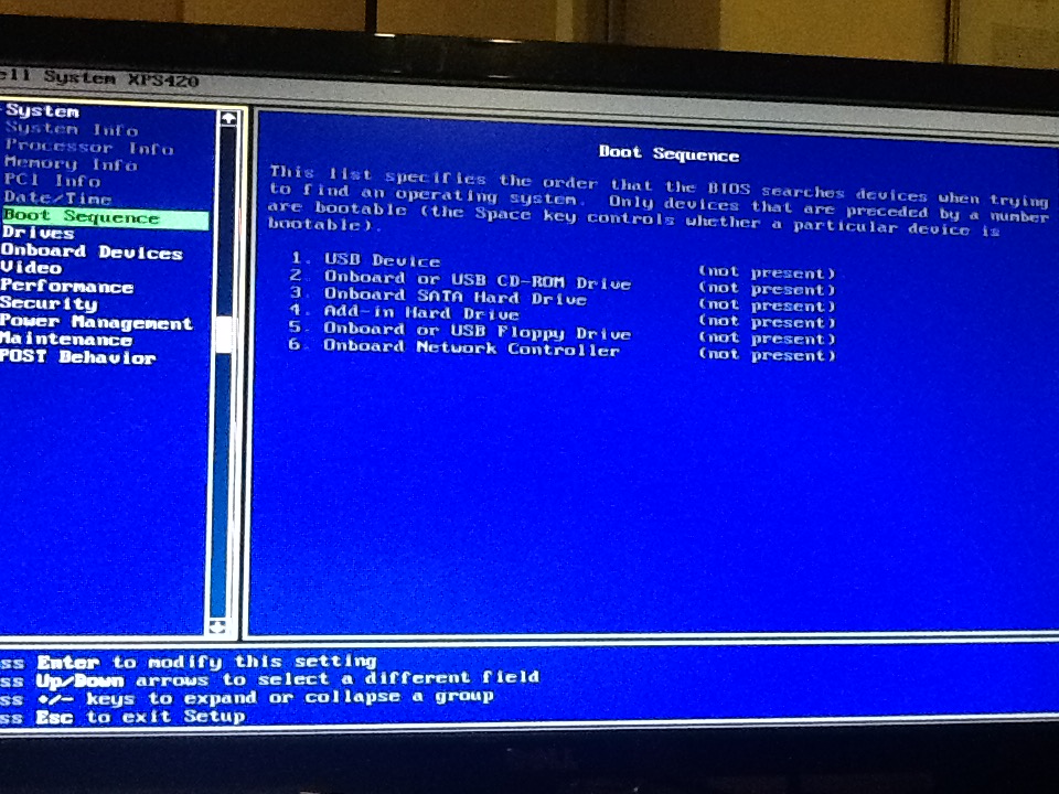

Correct. Now show pic of the Boot screen does it show your hard drive in the list?

The following screen

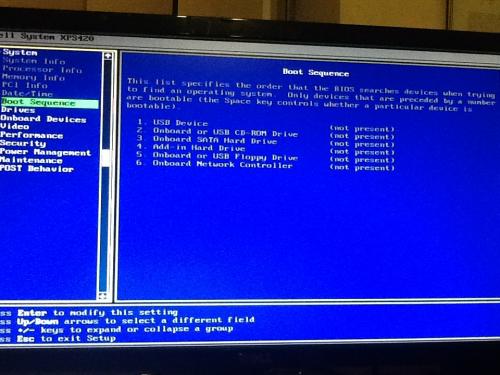

I am still on that screen
Hope this helps

Are you sure you connected the drive to SATA 0 and not another port. Please confirm.I believe on most Dells the SATA 0 port is Blue.
If it is connected to SATA 0, then replace with the other drive and provide the same screenshot.

Darrin,
I am afraid that the boot sequence screen shows the all drives are marked as not present.  I have undone, cleaned and remade all contacts, you are correct SATA 0 is the blue one, I have swopped the leads over, and exited the screen and rebooted on each element of the process, at least twice, to ensure that all leads are seated, it has made no difference.
I have rebooted with alternate drives and the USB ISO in on each time, also without the USB ISO, and each time the system hangs,
i have changed the SATA setting to SATA 0 OFF ; SATA 1 ON;
With the seagate drive ; nothing, not detected

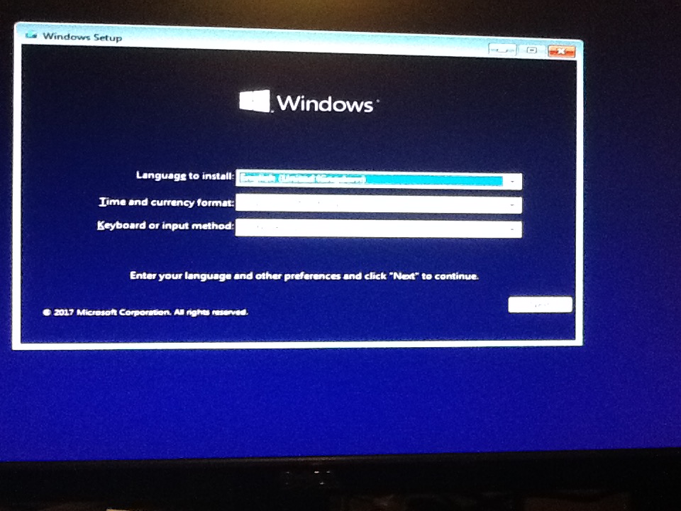

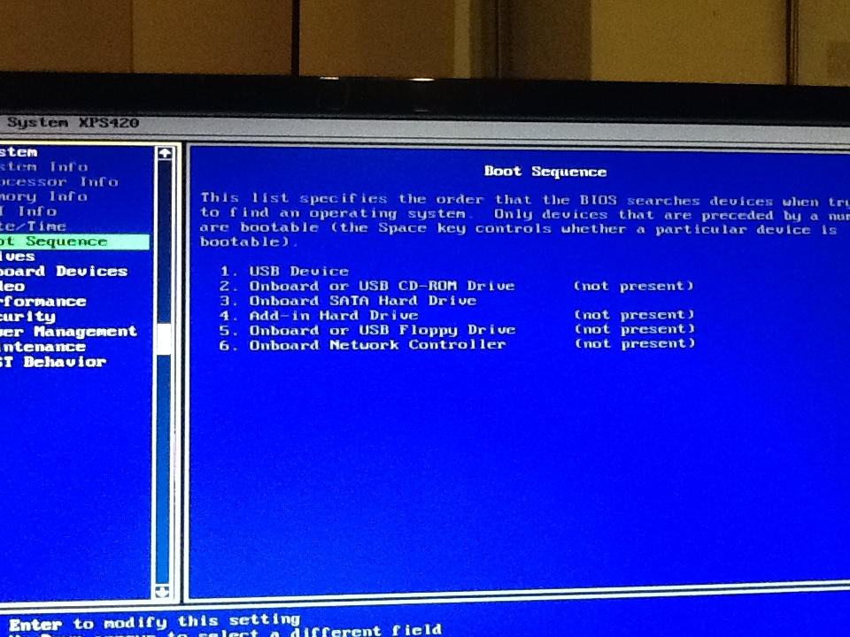

with the WD drive connected to the SATA 1, It has gone to the windows setup and is now showing what you can see in the photo, I have had to send the photo separately as im having a problem with screen shots and will use a borrowed ipad.
I am also afraid that we are coming to a reasonable conclusion on this, I feel that I sense your frustration with the process, and with my inexperience and inability to grasp what to you must be basic concepts, I would appreciate it if you could let me know if you want to continue with this.

As you can see it shows that both the USB Device and an onboard SATA hard drive have been detected, again the hard drive is in SATA port 1, at this time the USB Iso drive is in

I am happy to work with you a little longer. I think we are close.
With the WD drive connected to the SATA 1, It has gone to the windows setup and is now showing what you can see in the photo.
Please show me a pic of this screen. I don't see a Windows setup screen?

If you mean the screen you posted then that is okay and it looks like it is finally recognizing the drive so we can move on to next steps.

to get to the windows setup screen i will have to reboot is that ok?

Sure we can try that first if you like, but I think we have to repair the drive first. Go ahead and get to the windows screen and post picture.

Windows setup screen, surprisingly all I did was hit the esc key save and exit and it came out to the w10 logo and slowly loaded to this screen
