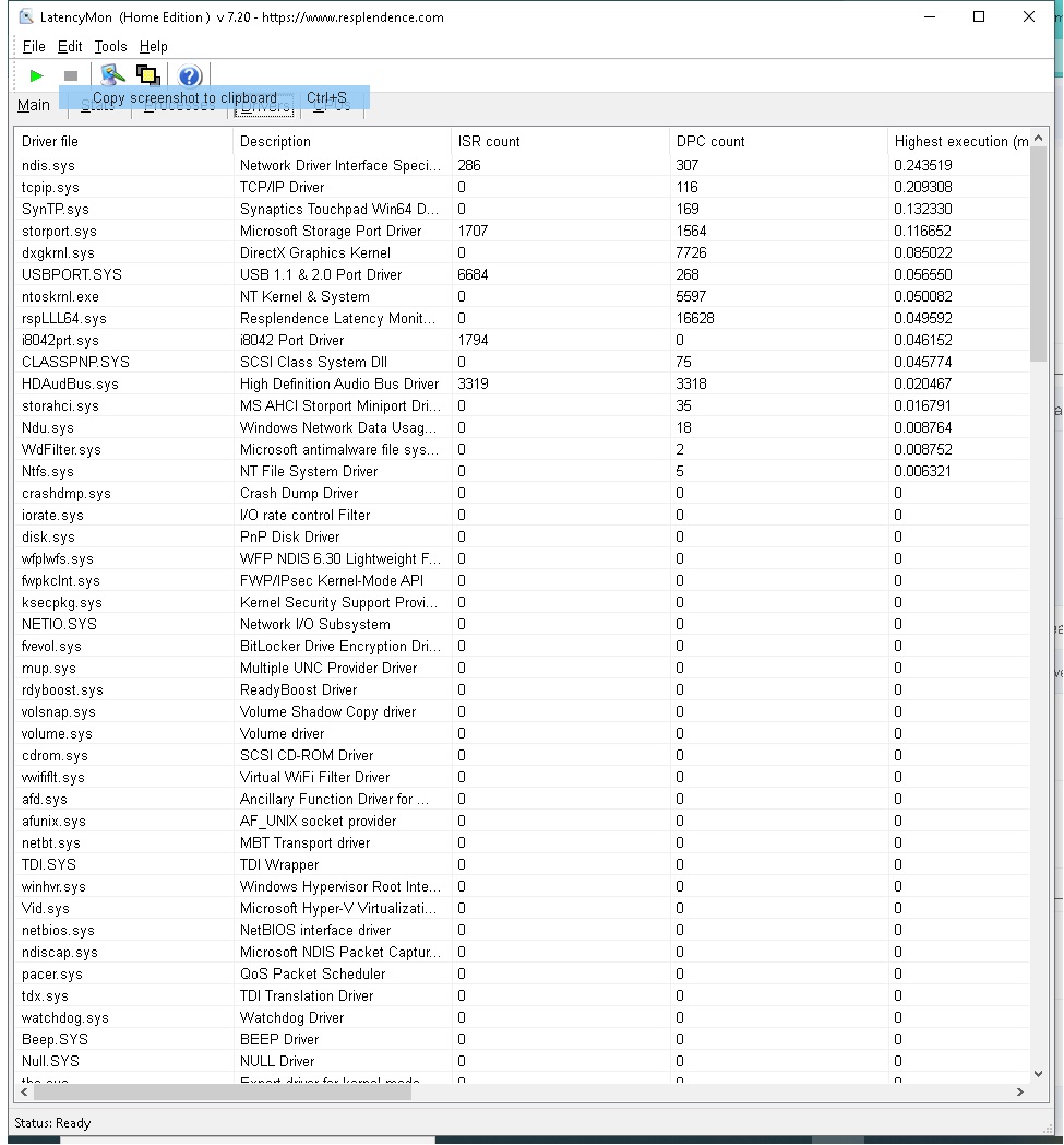

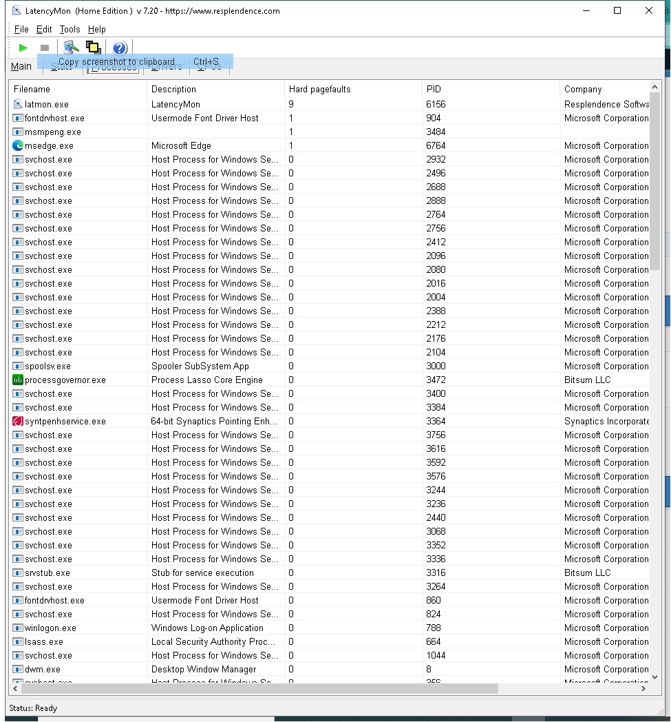

LatencyMonWEdge&YT
1:09 AM (30 minutes ago)
CONCLUSION
LatencyMon has been analyzing your system for  0:00:35  (h:mm:ss) on all processors.
SYSTEM INFORMATION
Computer name:                                        HAL900
OS version:                                           Windows 10, 10.0, version 2009, build: 19045 (x64)
Hardware:                                             HP G61 Notebook PC, Hewlett-Packard
BIOS:                                                 Default System BIOS
CPU:                                                  AuthenticAMD AMD Athlon™ II Dual-Core M300
Logical processors:                                   2
Processor group size:                                 2
RAM:                                                  7932 MB total
CPU SPEED
Reported CPU speed (WMI):                             20 MHz
Reported CPU speed (registry):                        1995 MHz
Highest measured interrupt to process latency (µs):   88.0
Average measured interrupt to process latency (µs):   8.918203
Highest measured interrupt to DPC latency (µs):       74.0
Average measured interrupt to DPC latency (µs):       2.993141
 REPORTED ISRs
Highest ISR routine execution time (µs):              53.497243
Driver with highest ISR routine execution time:       storport.sys - Microsoft Storage Port Driver, Microsoft Corporation
Highest reported total ISR routine time (%):          0.059233
Driver with highest ISR total time:                   USBPORT.SYS - USB 1.1 & 2.0 Port Driver, Microsoft Corporation
Total time spent in ISRs (%)                          0.163306
ISR count (execution time <250 µs):                   13790
REPORTED DPCs
Highest DPC routine execution time (µs):              243.519298
Highest reported total DPC routine time (%):          0.158315
Driver with highest DPC total execution time:         dxgkrnl.sys - DirectX Graphics Kernel, Microsoft Corporation
Total time spent in DPCs (%)                          0.431455
DPC count (execution time <250 µs):                   35828
DPC count (execution time 500-10000 µs):              0
 REPORTED HARD PAGEFAULTS
Process with highest pagefault count:                 latmon.exe
Total number of hard pagefaults                       12
Hard pagefault count of hardest hit process:          9
Number of processes hit:                              4
 PER CPU DATA
CPU 0 Interrupt cycle time (s):                       1.378949
CPU 0 ISR highest execution time (µs):                53.497243
CPU 0 ISR total execution time (s):                   0.111568
CPU 0 ISR count:                                      12996
CPU 0 DPC highest execution time (µs):                243.519298
CPU 0 DPC total execution time (s):                   0.241939
CPU 0 DPC count:                                      32174
CPU 1 Interrupt cycle time (s):                       0.342011
CPU 1 ISR highest execution time (µs):                11.038596
CPU 1 ISR total execution time (s):                   0.00290
CPU 1 ISR count:                                      794
CPU 1 DPC highest execution time (µs):                97.564411
CPU 1 DPC total execution time (s):                   0.060485
CPU 1 DPC count:                                      3654

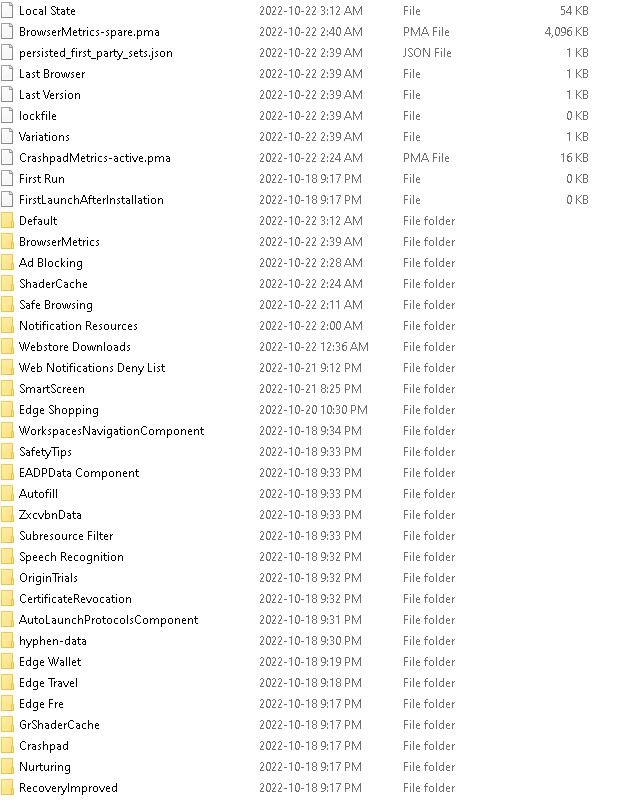

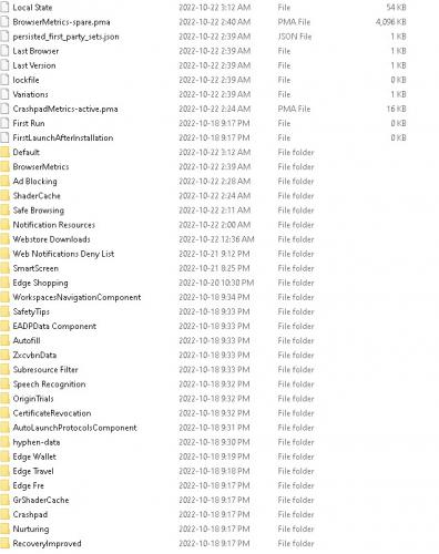

C:\Users\Rockets\AppData\Local\Microsoft\Edge\User Data
SCREEN PRINT OF FOLDER CONTENTS

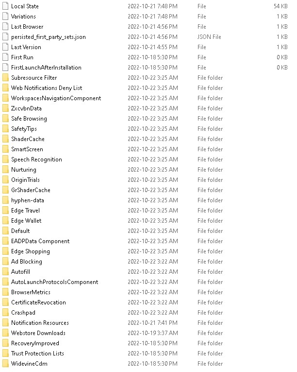

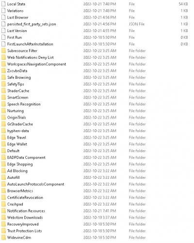

C:\Users\doher\AppData\Local\Microsoft\Edge\User Data

#70
ForrestGump
ForrestGump
  • 91 posts
YT Link used when running TCPVIEW
https://www.youtube....h?v=yxepeVL_ddk
#71
ForrestGump
ForrestGump
  • 91 posts
Attached File  tcpviewWEDGE&YT.txt   9.4KB   252 downloads
#72
  • 24,743 posts
Dxdiag doesn't see any problems.
Your PC is a laptop, right?  Does the battery still work?  I have seen laptops slow to a crawl because of a bad battery (even when plugged in).  The only symptom was a high Interrupts in Process Explorer.  If the battery is the original that came with the PC it's unlikely to still be good.  You might try shutting the PC down then removing the battery and try running it without the battery.  See if you see an increase in speed or a reduction in Interrupts in Process Explorer.
#73
ForrestGump
ForrestGump
  • 91 posts
Yes, HP laptop, Battery died a yr ago so it is not installed, Laptop Screen backlight failed as well so I was using an RCA manufactured adapter; with 1 HDMI to 3 RCA outputs adapter from the laptop to the RCA Video/Audio inputs of a Panasonic 32 Inch GAOO CRT, But the picture detail was not very good so now I am using a KA2, 27 Inch, ACER Monitor for Video with a HDMI connection & I use the  Laptop headphone jack back to the CRT audio input using a mini headphone male to 2 female RCA plugs cable, The output of the CRT inputs into my 50 year old Marantz Receiver & a Sony AV receiver, I use them for the 8 speaker & 2 Subwoofer sound system! LOL
Edited by ForrestGump, 22 October 2022 - 10:54 AM.
#74

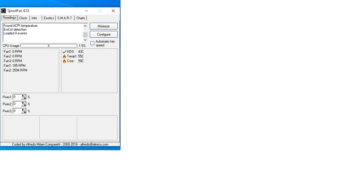

  • 24,743 posts
Could it be overheating?  Get Speedfan:
Download, save and Install it (Win 7+ or Vista right click and Run As Admin.) then run it (Win 7+ or Vista right click and Run As Admin.).
It will tell you your temps in real time tho the default is to show the hard drive temp in the systray.  You can change it:  Hit Configure then click on the highest temp and check Show in tray.
Win 10 hides icons by default so: Settings, Personalization,  Taskbar, Select which Icons appear on Taskbar,  then turn Speedfan ON.
With no other programs running what is the highest temp you see?  Run an anti-virus scan, play one of your games or watch a video for at least 5 minutes.  What is the highest temp now?
We don't really want it to go over about 65 under load.  If it does it usually means either the fan is defective (speedfan should tell you your fan speed so you can see if it is running) or (most likely) the interface between the fan and the heatsink is clogged with dust. The best fix for a clogged heatsink is to remove the fan (not the heatsink or heatpipe) and vacuum out the heatsink.  However on some PCs this is major surgery.  Sometimes you can blow air backwards through the exhaust vent while vacuuming at the input vent and if you are lucky it may clear the heatsink.  Don't do it too long as the fan may overrev.
#75
ForrestGump
ForrestGump
  • 91 posts
Laptop is running very hot, seems to be only 2 fans, 1 runs @ 185 RPM & the other @ 2,594 RPM! Temps are near 60C, I did blow out all the vents with compressed air, no change in temps,
I think I will reduce the powerplan back to Balanced given the age of this Antique relic of Tech
Also tagged with one or more of these keywords: Virus
