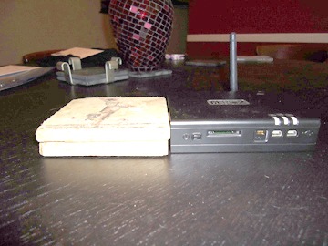

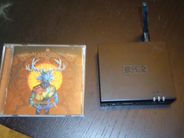

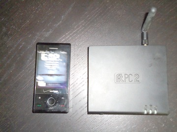

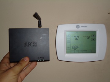

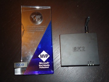

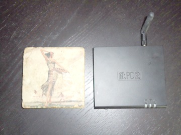

The fit-PC2i is a fan less net-top PC that comes in a very small, neatly packaged cast aluminum case measuring 4? x 4.5? x 1.05? (101 x 115 x 27 mm) . With the hard drive installed it weighs 13 ounces (370 grams), which is less than a pound. The compact size makes the device extremely easy to hide amongst the electronics on your entertainment system, or you can use the optional VESA bracket and hang it directly from the back of your TV (or monitor, or anything else with a VESA hole pattern in it). The fit-PC2i uses a measly 8 watts of power at full load and 6 watts at low CPU load, and when it’s in standby it only sips 1 watt.

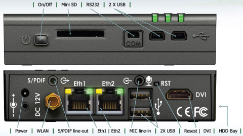

CompuLab currently offers several different models of the fit-PC2i with various configurations. All models come standard with Atom 1.6ghz or Atom 1.1Ghz processors, 1 Gb of RAM (upgradeable to 2Gb), a 160 Gb SATA hard drive (SSD available or diskless), a miniSD slot, onboard Intel GMA500 graphics, DVI-D out through an HDMI port, 5.1 channel S/PDIF, 4 USB 2.0 ports (two mini, two standard), 2 Gigabit Ethernet ports, 802.11g WLAN, and a serial port (also USB mini with adapter). The review unit that I was sent is the company’s new 2.0 Ghz model which comes equipped with a 2.0 Ghz Atom processor and 2Gb of RAM, so it’s their newest and most powerful model (should be available for purchase in the next 2 to 3 months).
The system can come preloaded with Windows 7 Professional (the review unit has 7 pro), Windows XP Home SP3, or Ubuntu Linux 9.10. Of course you can also get it without an OS and load whatever you want. That’s a lot of stuff to cram into a tiny package.
