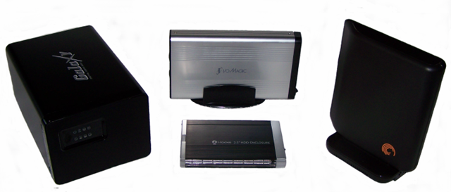

Simple USB Enclosures: There are a wide variety of enclosures available that will utilize either a 2.5 inch or 3.5 inch hard drive to create an external drive of the size you choose.  You’ll find everything from a “Plain Jane” box to cases that have bells, whistles, flashing lights, and sirens.  Well…maybe not sirens, but  there are some pretty flashy units available out there and you can build a viable backup solution that fits your tastes by simply adding an internal HDD to the enclosure of your choice.  Prices range from less than $20.00 to over $150.00 (not including the HDD’s or backup software).
External Hard Drives: If you don’t want to build your own device, there are also external hard drives available that need only be connected to the machine and you’re off and running.  Just about every manufacturer that offers hard drives also offers these devices and with the “plug and play” ease of use, they are a good choice for anyone needing external storage solutions.  Prices range from about $50.00 (60GB) to about $2000.00 (6TB).  They do not include backup software.

For this project, I want to build a 1TB (~1,000 GB) device that’s expandable  with an automated backup capability that is affordable and versatile.  I chose Galaxy enclosures for this as they offer hot swappable drive bays, and offer more versatility when configuring the drives.   This is a very convenient feature in most respects, but will likely not be used much by the normal computer user.  The drives can be configured to be used as a single large drive, or you can use the drives separately
First, I used Galaxy Metal Gear’s 3508UC One Button Backup enclosure which includes PCCloneEX Software.  These are metal enclosures that have locking access doors for security, have active cooling, and connect up via either USB or FireWire.  Pressing the button on the front of the enclosure starts the backup.
3538UCThis enclosure offers several attractive options including hot swappable drive bays (2) as already mentioned.   Hot swapping allows one to remove and replace drives without powering down the enclosure or having to use the “Safely Remove” feature in Windows. The enclosure also has the ability to utilize all the drives installed in it as a single large drive, or the drives can be configured to show as separate drives, and you can use drives of different sizes together.  Each configuration can be handy depending on the circumstances.
I installed two 1TB SATA HDD’s, first as a single large drive.  I immediately found a problem with this (stated in the documentation supplied with the unit).  This configuration uses JBOD (Just a Bunch Of Disks) which combines the installed drives into a single logical drive.  This is known as Spanning or Concatenating  the drives and it has it’s draw-backs.  Removing one drive, whether purposely or through a hardware failure, will effectively destroy the data on both drives.  Not what you want in a backup solution.  When configured as separate drives, however,  I was presented with a very viable backup solution and the drives can be removed and installed at will.
